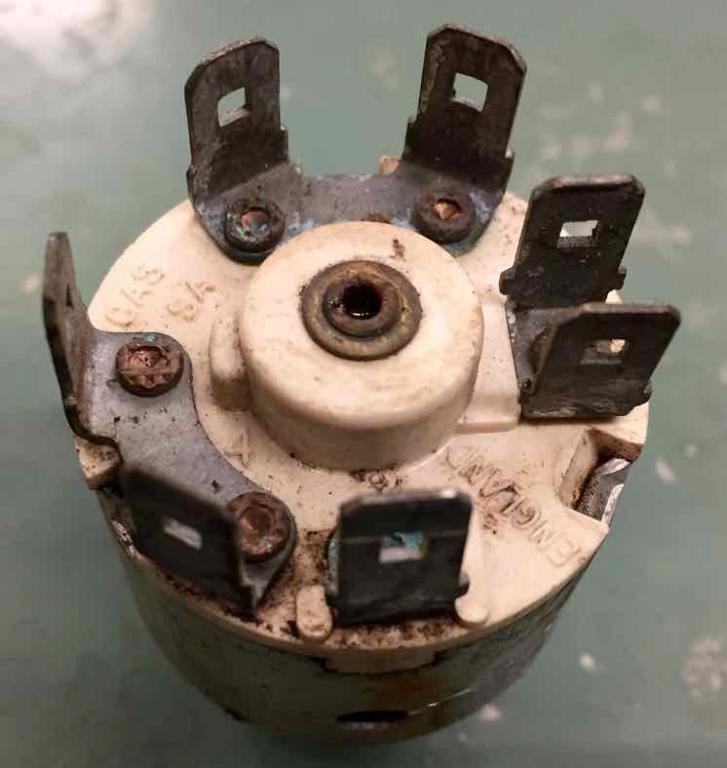

    My vehicle is a '71 SWB, neg ground, 2 1/4 petrol. When I crank the engine to start it, It will ONLY START when I RELEASE THE KEY. Makes it hard to know when the engine is "ready" to start. It's probably a mis-wiring of the ignition switch, but a picture or drawing of what goes where would be very helpful. The schematics don't help. HELP!

Name:	Ign Switch.jpg
        While rewiring for 4 way flashers yesterday I had a chance to check out the ignition switch. Mine is also a '71 IIA 88. If you look closely at the back of your ignition switch you'll see that the terminals are labeled 1 through 4. Position #1, the double terminal at the top in this photo is 12v in. #2, as you turn the key clockwise, is ignition on, +12v to your coil. #3, the single terminal at the bottom is the momentary switched position, +12v to your starter solenoid. Position #4, the double terminal, turning the key counterclockwise from the off position, is the auxiliary power position. At one point I did manage to get the ignition switch wired like yours. A few minutes with the Ohm meter sorted things out.

          Thanks! I will see if I can sort this out since I now have SOME idea of what's going on!
