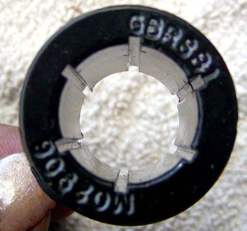

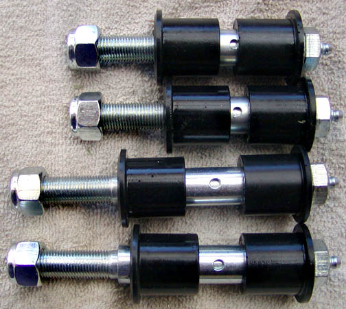

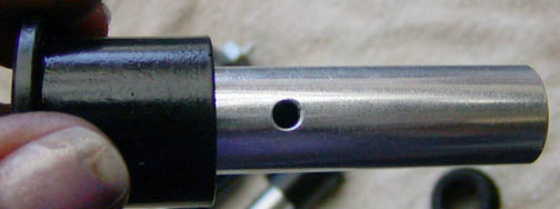

        Originally posted by woza
        Hi All
        Just a question on greasable poly bushings from GBR for a Series 11A 88 or 109. How do they hold up. There is a thread from around 2010 so some info on life span would be interesting.
        I've had a set under my Dormie for, humm, probably going on about 9 years now. They have held up very well. Everytime I do an oil change or pressure wash the underside of my truck I get out the greese gun and grease everything under the truck, including the bushings. Mine are fine thread.
