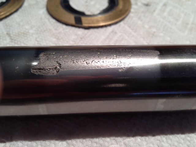

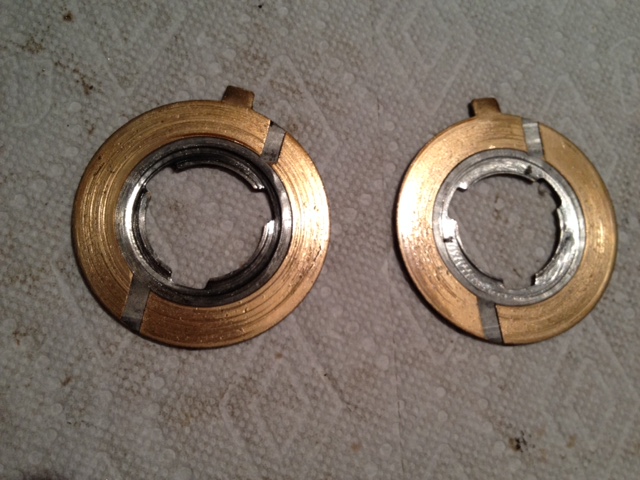

    So I am rebuilding the entire transmission on my 1961 109 Station Wagon. It is a pre-suffix A transmission. I'm making an inventory of the things I need, and am running into a few snags. Some parts are NLA.
    I took the transmission apart because I needed a new synchromesh, but I decided I was going to take everything apart, and put in all new seals, bearings and gaskets, and replace whatever else needs replacing.
    Looks like my intermediate shaft needs to be replaced, along with the thrust washers, and needle bearings. Just got off the phone with our hosts, and suggested I get on here and see if anyone could help me.

      you are not through the bearing material on the thrust washers so you can probably use those with appropriate shims. I have some nice used intermediate shafts. I believe I also have bearings
