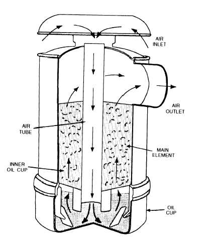

    Presuming you want to stay authentic, the trick is finding a raised air intake oil bath air filter assembly that won't cost you your first born male son plus $200 to sweeten the deal.
    IIRC, Jason (I Leak Oil) modified a normal oil bath to be a raised intake type. Perhaps he'll post up a pic or two of his setup.
              All I did was replace the straight air tube with a new 90 degree tube that comes in from the side of the housing. Welded a round plate on top to cover the original hole, welded the new tube in place. The rest is just academic plumbing.
