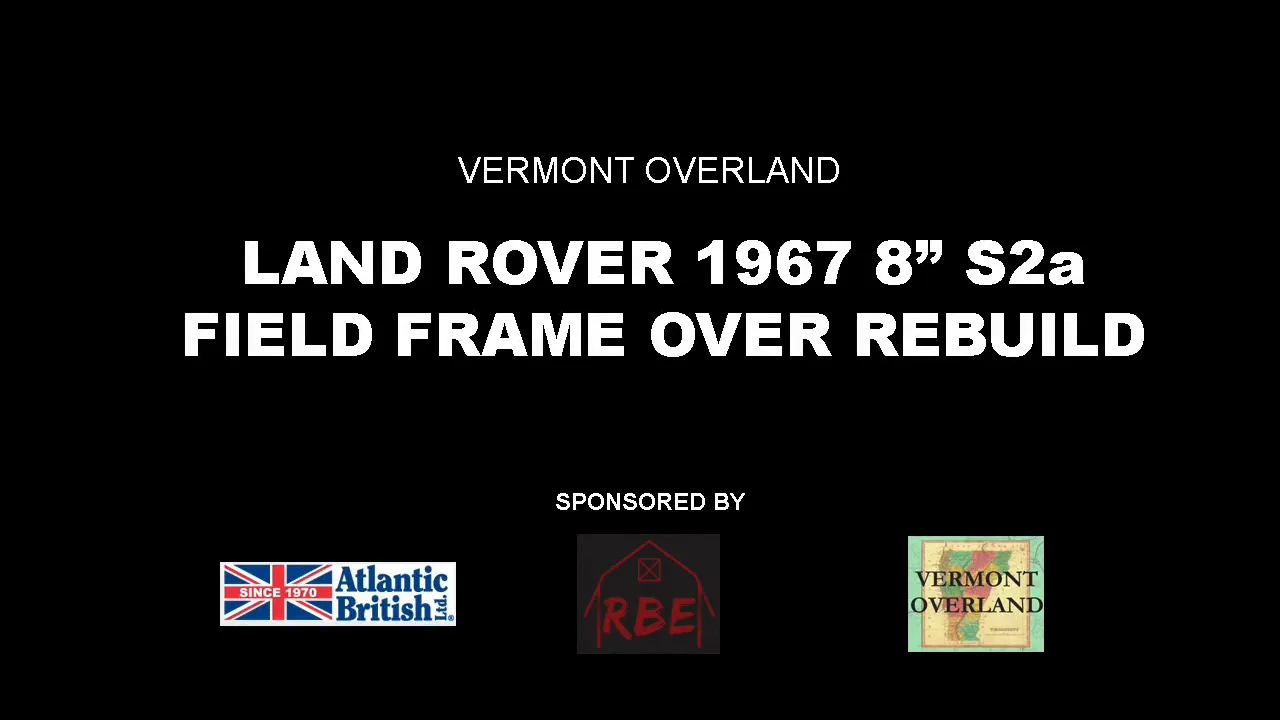

        I once participated in a frame over in a field for an event and we completed the frame over in about 30 hours. Maybe 48. We started Friday night and had it running Sunday morning. I'd say we had 10 men on the job with maybe three of them having completed a frame over in the past. We had a farm tractor as a fork lift and all parts on hand and ready to go.
        The key is to avoid disassembling the truck too far. Skip any of the ship fitter items until after you get the truck running. Choosing now to re-seal the transmission is likely to put you over your time budget unless you are comfortable that you can get it done in a day. You are better off power washing everything so that in a year's time, you can pull the transmission and do your re-seal when you have more time to.
        You can do it. Just be smart and don't choose now to address all those wish list items just because you are in there.
        Here is some inspiration for you.
        That video starts well after we started the tear down but you get the idea.
