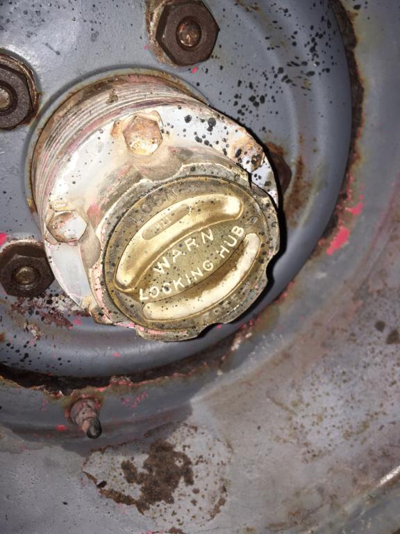

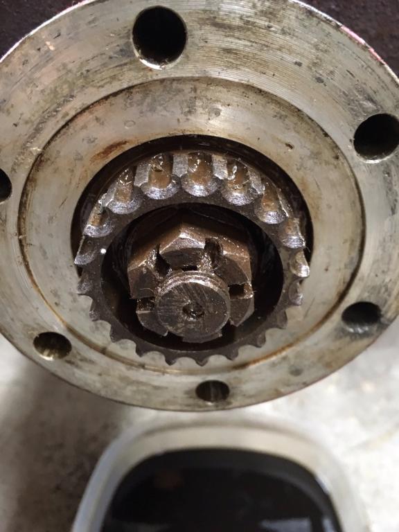

    Hi. I bought a bunch of boxes that came with a Land Rover frame. Lol. Got the engine started and now have to start on everything else. I've started working on the front warn locking hubs but can't for the life of me able to remove the nut without the whole axle from turning. Is there a special tool or key that I need? Any help would be appreciated. Thx

    I CAREFULLY use a large plumbers wrench to hold the outer teeth (with a rag wrapped around to avoid damage). Works for me anyway. I think some will advocate shifting into 4-wheel low in 4th gear and locking the parking brake and going after it, but on jack stands I just don't like that. YMMV.

      Impact.....
