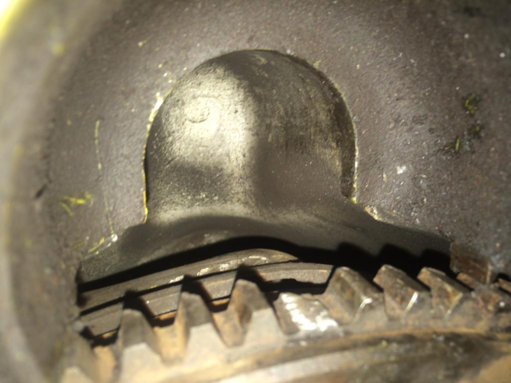

New series owner. I finally own a series after many years trying to find a good candidate and now I'm pretty sure it was a failed attempt. Rebuilt the entire fuel system and changed to electronic ignition and when I turned it over for the first time after pouring a little gas it the carb it started and idled until it ran out of gas. So I put more gas in it and it tried to turn over and then I heard a loud bang and a noise that sounded like something breaking and a splash of liquid. Not good! Took the starter out and now it looks like one of the teeth on the ring gear is broke off and now when I try to turn the engine with the hand crank it will not turn. Can someone enlighten me on how badly I hurt this thing and what exactly happened.
I appreciate any ideas
1969 series 2a petrol
