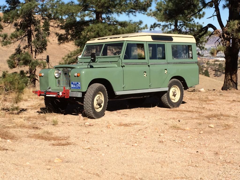

I'm curious about door latches. Looking at the 66 109 photo in this string, the door lock seems to be in the door handle recess. On my '71 SWB, the lock comes out of a separate hole in the door just behind the handle recess. Is that a later IIA or maybe Series III modification? I'm still frittering about trying to find a way to keep everything stock but be able to lock the doors, either have keys fitted, or replace the cylinder.
George - UtahComment
It was very common to upgrade the door latches on the 2a trucks to Series 3 (anti-burst) door latches. Series 2a door latches had the lock cylinder in the door latch recess (as pictured above) and Series 3 door latches required a hole through the door skin for the lock cylinder .
Sounds like your 71 has been "upgraded" to the later Series 3 style latches (as does my 1968 2a btw).1968 Series IIa
