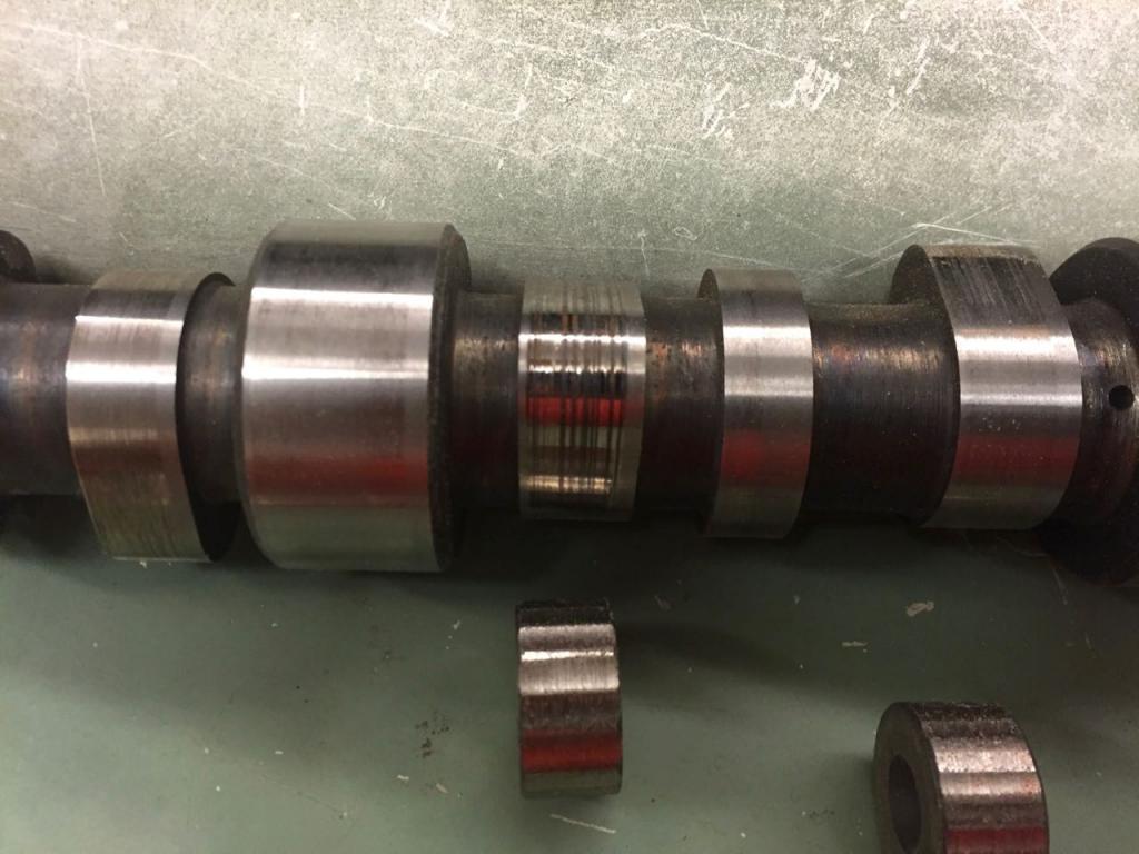

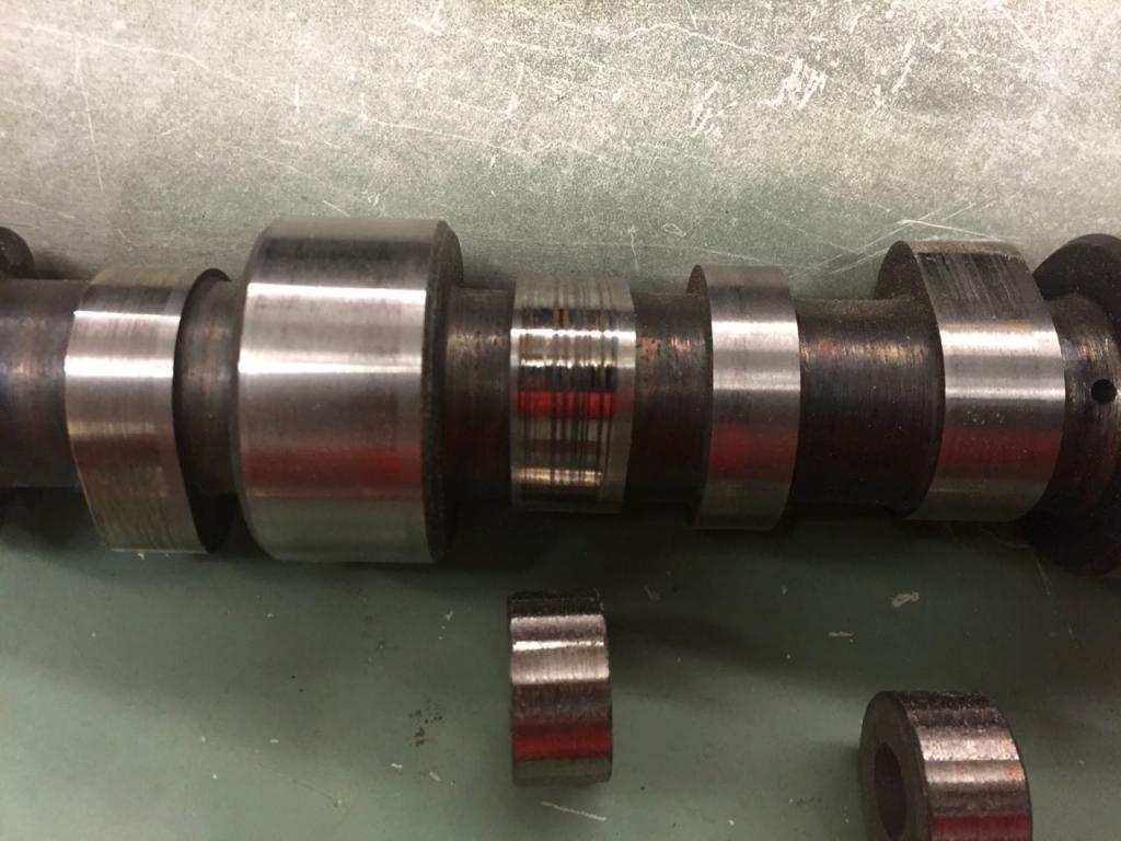

                  • kb1iaw
                    Low Range
                    • Mar 2015
                    • 13
                    #10
                    Originally posted by griswald
                    Thank you Les, to clarify, you mean change all tappet roller assemblies, and also the camshaft, correct?
                    I had a trusted mechanic inspect the parts after I got some bad rollers that failed shortly after the engine rebuild. The cam and tappets were damaged too. The tappet guides were still in good condition so I reused those.
