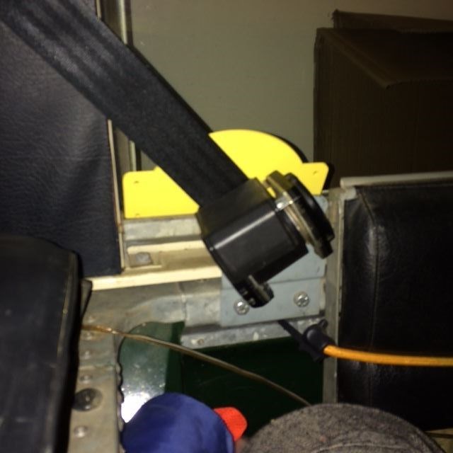

    Mine's mounted to a bracket behind the door opening, onto the galvanized trim. See photo:

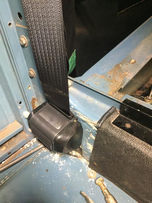

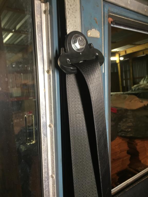

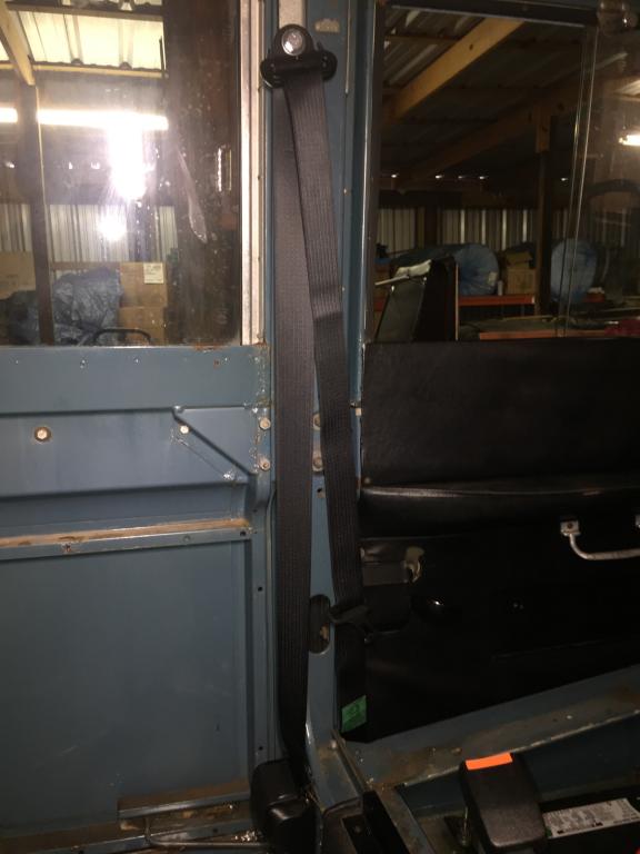

ID:	169645Here is how I did mine

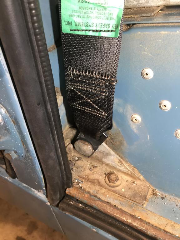

        Hey, Armordave,
        How did you remove that bolt that holds the seat belt to the seat frame? There's no room to fit a socket.

            ArmorDave,
            How do you loosen that large bolt that the original seat belt is fastened with to the seat box? Because the door jamb is so close (not to mention that bolts holding the triangular bracket to the body), I can't get a socket or even an open-ended wrench on it.
