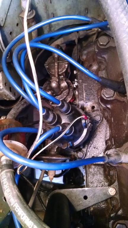

Hello all. I am new to the series Rover's (have always had Discoveries) and found this one in decent running order in a barn last fall. It is a 1973 US Series-3 88 with the 2.25 petrol. I recently developed an oil leak from this roughly 10mm diameter 2cm deep hole between the distributor and head. The hole has no threads. At idle, the oil level will slowly rise in this hole and if rpms increase, oil will flow out rather quickly. When first checked, the oil looked to be about a quart high, but after lowering the oil level to right between Low and Hi, the leak persists. Any help/advice would be greatly appreciated.
