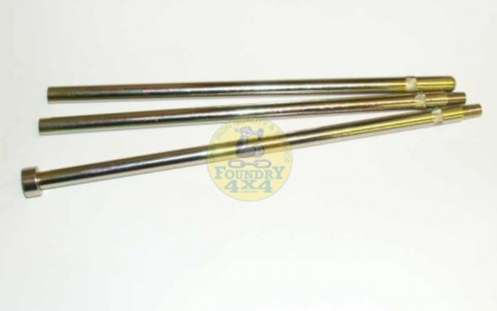

                Foundry 4X4, in the UK, sells a X Shaft Removal Tool which is, essentially, a collapsable rod that has a strong a$$ magnet at the end. I imagine you could experiment with making one yourself with off the shelf bits.
