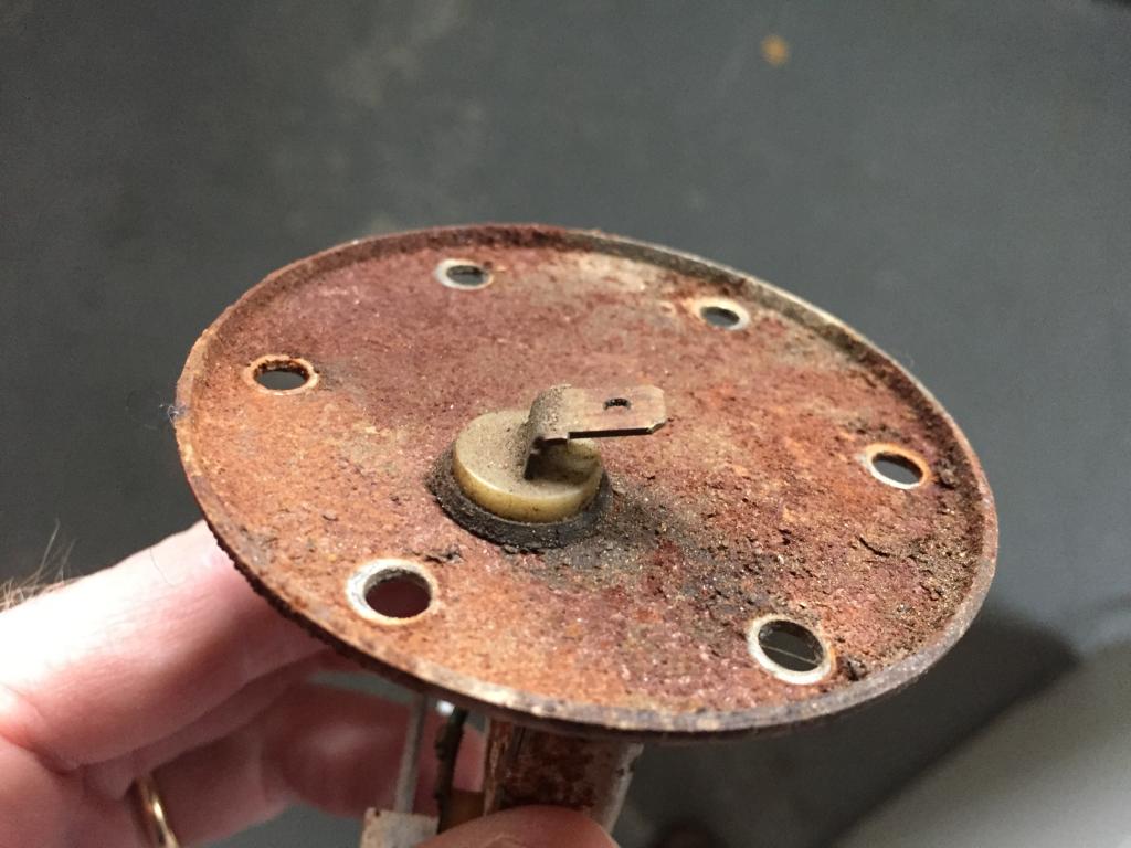

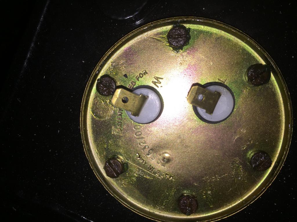

2. The new Proline sender has two electrical connections (see left picture) while the OEM sender I removed has only one connection (see right picture). When I utilize the connection on the new sender labeled "L" the gas gauge does not register. When I use the connection labeled "M" the gas gauge registers fuel but very slowly and not completely. I put 5 gallons of gas in the truck but the sender and gauge register maybe 1/4 of a tank. The truck is on flat ground so that should not be a factor. Anyone experience this issue with ProLine senders?
I'm tempted to put the original sender back in the truck. I thought since I was upgrading the tank I would upgrade the sender.....
