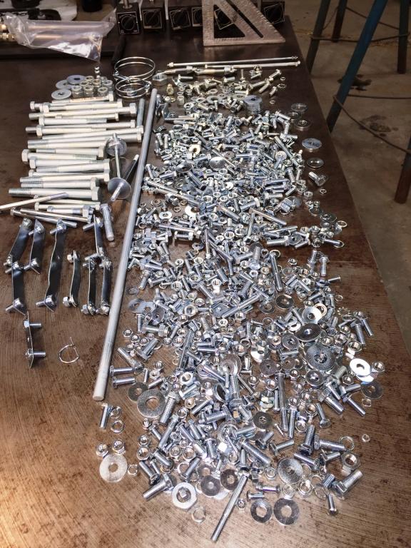

What Colin said, or get yourself a bunch (one hundred or so each) of 1/4-28 x 3/4 & 1/4-28 x 1 bolts with nuts, washers, lockers to match...........I keep both 316 stainless and grade 8 in stock. www.boltdepot.com has served me very well.
I just went through the cleaning and re-plating of all the original hardware for a Series 2........time consuming to say the least, but if you know you have most of the original hardware in the truck it may be worth preserving. Bass Plating in CT did my plating.
Been following your restoration - freakin awesome.What Colin said, or get yourself a bunch (one hundred or so each) of 1/4-28 x 3/4 & 1/4-28 x 1 bolts with nuts, washers, lockers to match...........I keep both 316 stainless and grade 8 in stock. www.boltdepot.com has served me very well.
