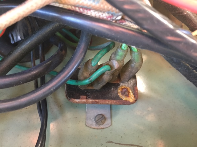

    I need to test the voltage regulator/stabilizer in my 1970 IIA. I guess the first question is which to I have? There's a black box on the engine side of the bulkhead that clearly says "voltage regulator" but inside the dash behind the instrument panel there's something that looks like it could be a stabilizer (see picture, yes it's upside down). Could I have one of each?
    Then, how do I test it (them)? I read in another post (http://forums.roversnorth.com/showth...tage+regulator) that it should have 12-13v going in and an average of 10v going out. I know this is a basic question, but how do I test that? (I have digital and analog meters).

      I just tested the stabilizer and the needle on my meter stayed about 11v for a second or two then started bouncing around from around 0 to 10v. So I guess I need a new one.
        I'm pretty sure that's how it should behave. That being said I replaced mine with a $1.50 IC-7810.
          The voltage stabilizer is a bi-metal strip. It takes a second to heat up, then begins to bend and unbend, breaking and then making contact to complete the circuit repeatedly while energized. This calibrated turning on and off the 12v circuit makes it seem like 10v coming out of the stabilizer, though it is realy switching 12v on and off a lot of times.
          A digital meter can react to the voltage change too fast and may not read this well. An analog voltmeter can't react fast enough to show the 0-10v switching and should read a steady 10v if all is well.

            That's about what I thought. Since mine doesn't show a steady voltage, I went and ordered a new one from Moss. We'll see if that solves the problem I've been tracking down (weird fuel gauge readings).
