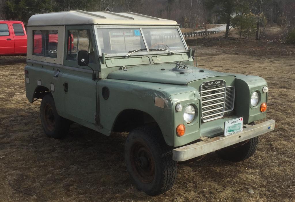

    Hello everyone,
    New to the group. My girlfriend wanted a project and she decided on a 72' Series II Rover. Great rig. But, I come from a Land Cruiser background. This is my first venture into the British Stuff.
    Anyway, is there anything that can be done about the slop in the shifter without a rebuild. The truck shifts find but the shifter is self wobbles quite a bit.
    Any thoughts would be appreciated. Image of the Rover added for fun...

      That's a good looking project, sure seems to be a very solid starting point, hate to think what you had to give for one in condition like that, these days the price seems to be soaring.
