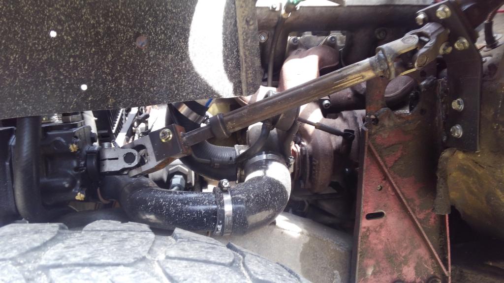

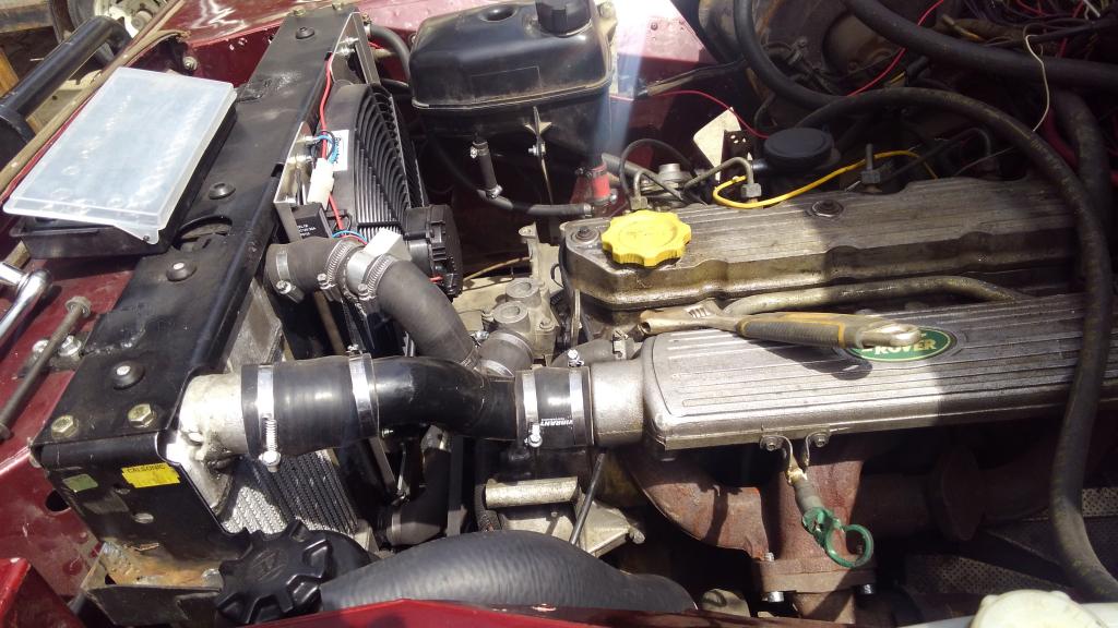

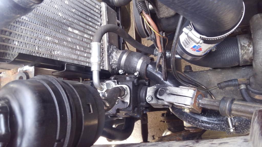

Went over this morning to pick up my son from College and on the way stopped to see the Rover. What a great job. Fitted a P38 power steering pump, fabricated new steering column, fitted the 200 disco manifold and turbo, disco rax and intercooler, moved the battery into the rear tub.
