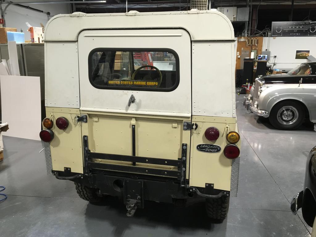

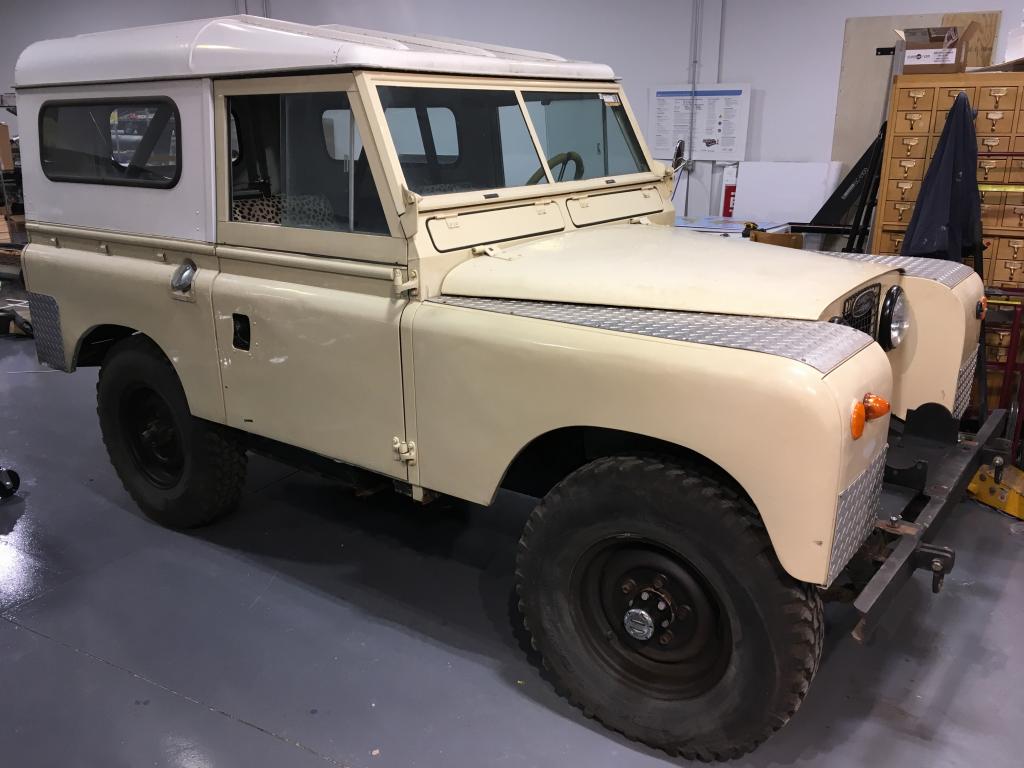

    Hello all,
    This is my first go round with owning a Series (and a Land Rover at that), so I'm about as green as they come. I recently picked up this 59' Series II SWB, but the seller didn't know much more about the 88 other than it was a west coast military truck that had made its way to a Montpelier garage.
    I haven't been able to dive in deep into the belly of the beast yet but rust seems to be minimal (no serious flaking anywhere in the cab, around the frame, etc.), which is exciting but also taken with a grain of salt. No pun intended.
    Anyway, if people have thoughts on this beaut, I'd welcome them.
    Thanks
    PS - if anyone has a hoop set they're trying to offload, I'm your guy (and a black canvas top if you've got that too).

      All the exterior lamps are wrong. Front bumper is wrong. Someone painted all the galvanized parts (ugh). Checker plate all over the front wings is a sign that there are problems with them. Wing mirrors missing. Chrome headlamp trim rings painted black. Galvanized grille painted black. Lower sills missing. Front apron panel missing.
      Despite these correctable things, it is a Series 2 so it's worth spending time and money on it. Hope you enjoy it!

        Hmm, weird placement of checker plate, interesting top without the rear small windows,
        agreed looks rust free, and nice color, congratulations, Rover on!

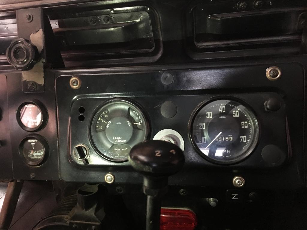

                  Replace the lights with original indicator and brake lights, they are very nice especially the early 59-60's series. Show us more photos please. How about the engine? Interior? I like the split tailgate hardtop, cargo type. Nice! Are those warn free lock in the front wheel?

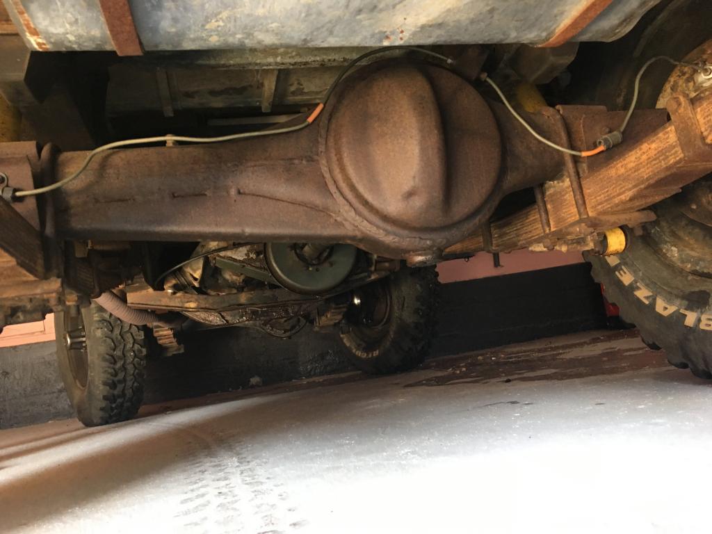

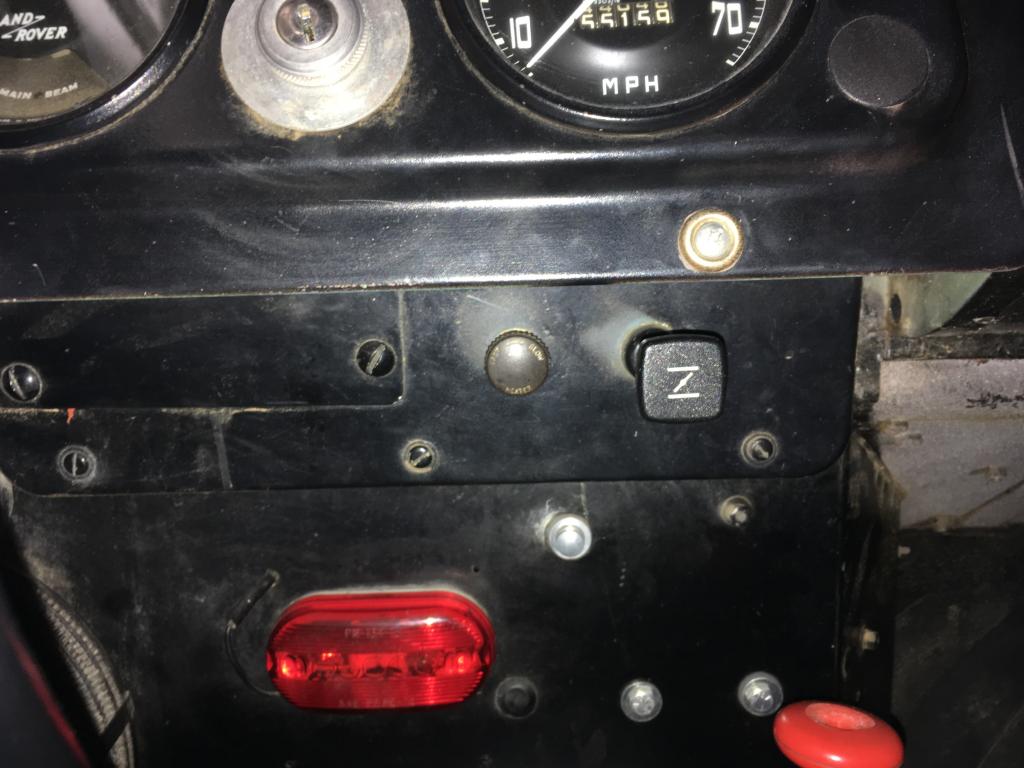

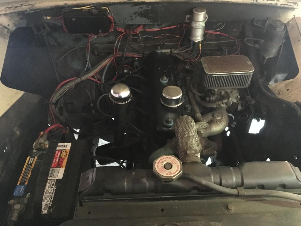

                    Lights are definitely on the list. Good news - crappy black paint on the headlights is coming right off.
                    Also, attached are a few more pics for info/critique.
                    Thanks again

                      Missing black hose from Pancake heater, aka (shin burner), lots of non stock wiring in engine bay, looks like there may be a repair or mod to the down pipe for exhaust.
