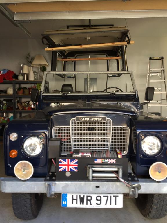

        You can see my set up in the background of this photo. Super easy hoist I found on Amazon and mounted to the garage ceiling studs. Top removal and storage is now a one person job.

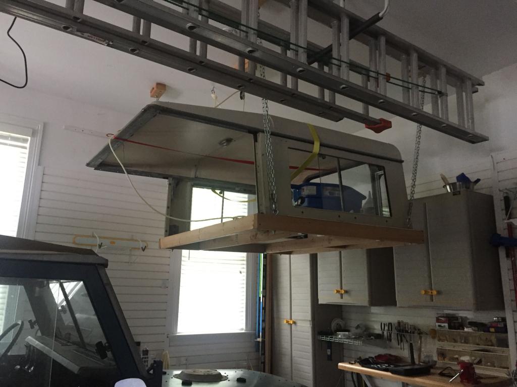

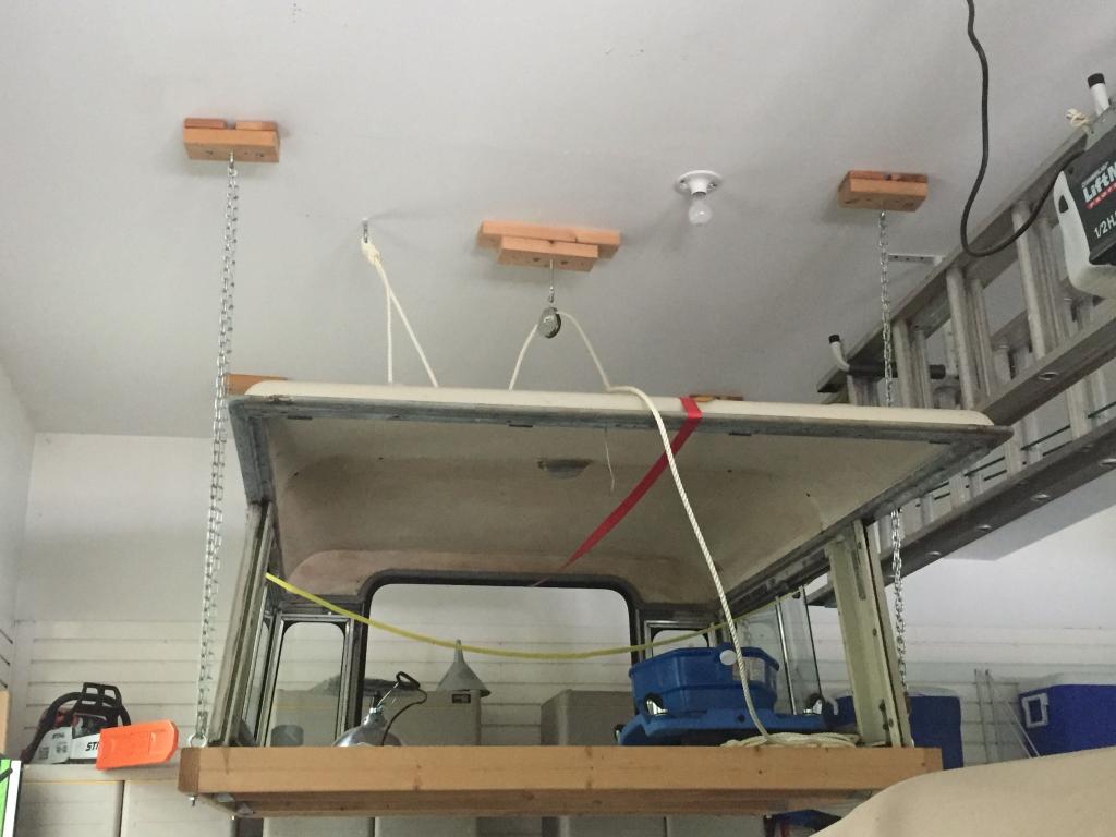

          I built a wood platform. Suspended it from the ceiling by chains at two corners (so platform was hanging perpendicular to the ground). Winched the hard top up. Swung the platform up and parallel to the ground. Connected chains at the other two corners of the platform. Lowered the hard top down onto the platform. Over engineered but that was half the fun.
