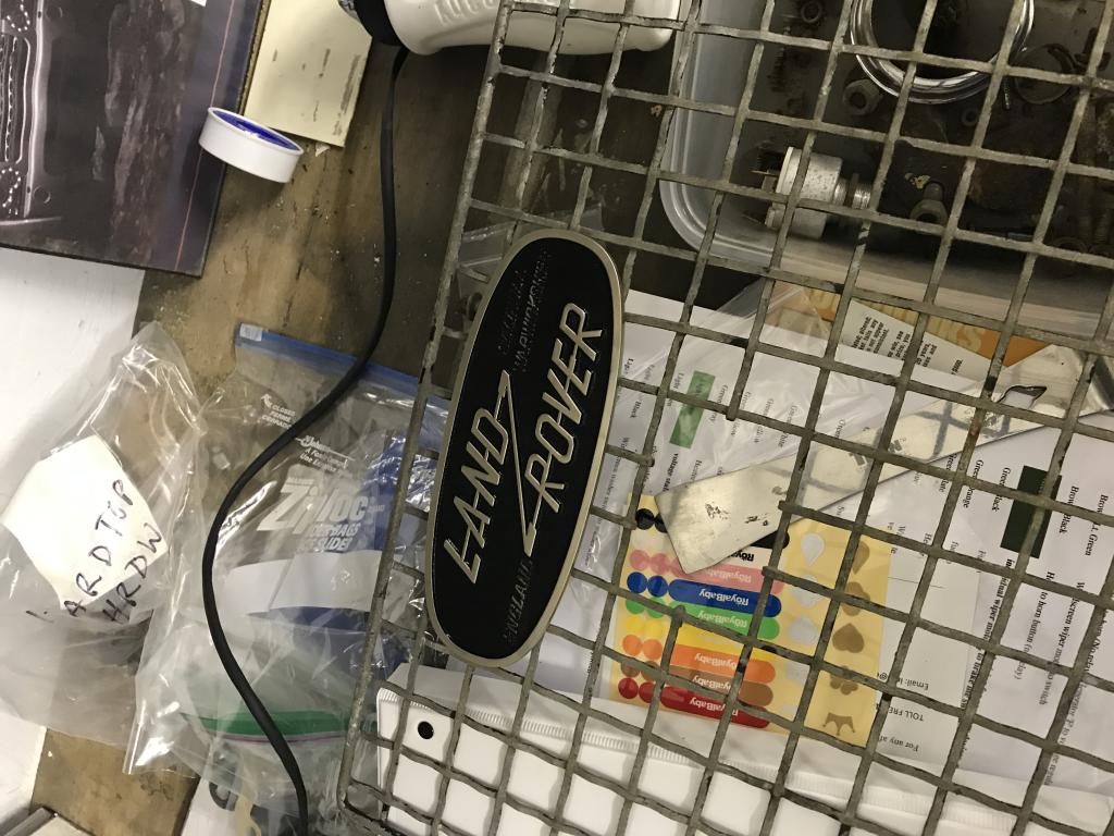

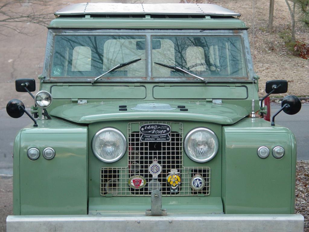

centre your grille between the headlights then drop it into the two retaining clips at the bottom of the radiator core support, just under the headlights. The badge is attached by screws that pass through the grille mesh and into the snap-in nuts near the top. That holds the grille fast by clamping it between the badge and the core supportComment
