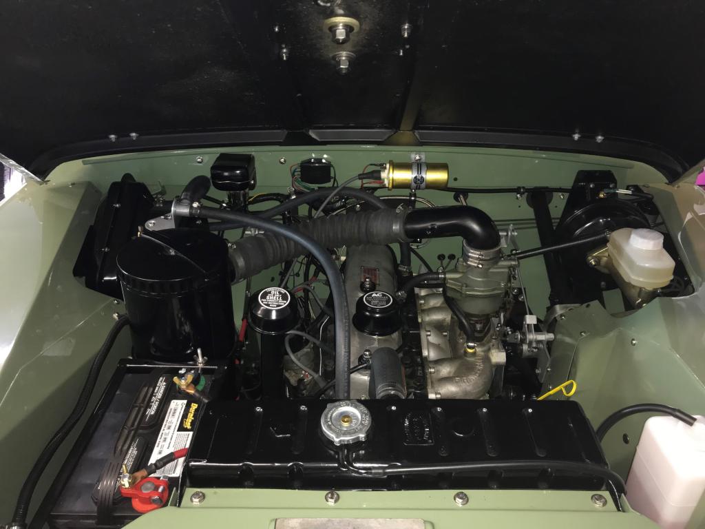

    I have oil coming out of my filler tube and low oil pressure during hard braking or hard turning once the engine has reached normal operating temperature. It will blow so much oil out that it will cover the engine and be dripping on the ground when I pull into the garage.
    I do not have high crankcase pressure as the case is vented to the atmosphere via the filler tube and the valve cover cap.

    Hello All. I need advice. A few months ago after a short 30km drive I found my engine to be completely covered with engine oil. The breathers were'nt clogged as I built an advanced breather system. I found the rocker cover gasket to be cracked and as the oil seeped out, the fan blew it all...
    Also, the RAC Land Rover Series I-III Expert guide says that oil spraying from the filler cap is due to poor rings or bores. I completely understand this and do have a low cylinder compression on my #3 cylinder.....but this does not explain the volume of oil making its way up the filler tube.
    I assume the oil is foaming somehow. Since there is no way to build up pressure in the crankcase with it doubly vented the oil can't be getting pushed out. Something has got to be aerating the oil and I really don't want to end up like the poster on the LRUK forum that rebuilt his engine TWICE without resolving the problem.
    My worst case scenario is a block crack allowing combustion gasses from #3 cylinder to an oil line of some sort but I'm really hoping someone has seen this and can say....oh it's just...

    Probably will have to do some disassembly. I've seen Volvo pushrod engines with worn rocker shafts resulting in too much oil being pumped to the top of the engine with similar results, but they didn't have the side mounted oil fill tube and cap. In this case the crankcase pressure it apparently too high. Bad piston rings, or if the engine was recently rebuilt maybe the rings were installed wrong?

        He posted an update on Guns and Rovers, where he found cracked rings on cylinders 2 and 3. He's in the process of gathering parts to put it back together. No mention of any block or head issues found during inspection.
