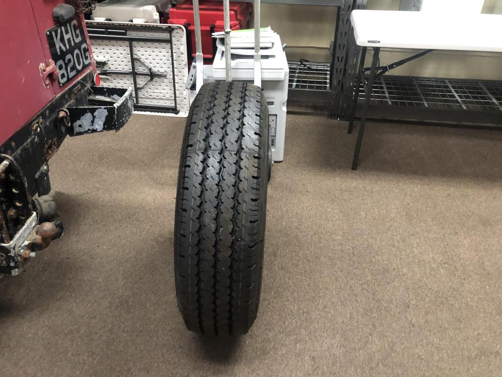

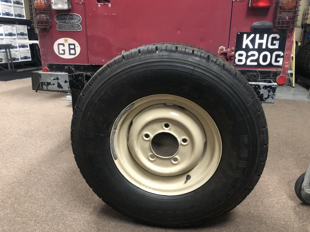

    This first 2 picture are standard Land Rover rims with a very heavy duty M-tire in the same size your tire

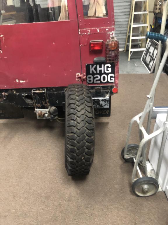

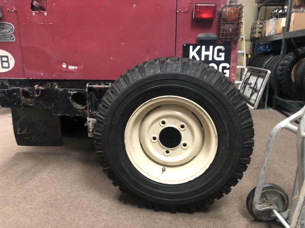

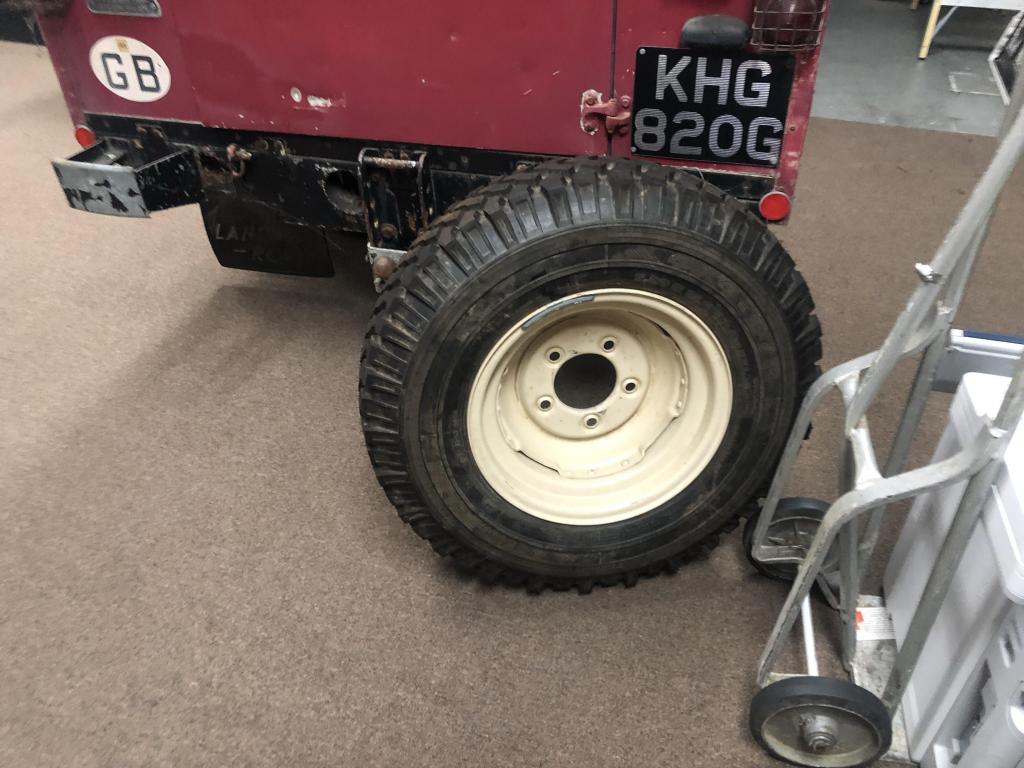

    The next 3 pictures are XZL tire on a Land Rover Rim, with a deeper of set.
    The XZL wear real fast. Only run them for off trips
    I would buy more of the large off set rims, for off tires, as it give the rover a wider profile.
