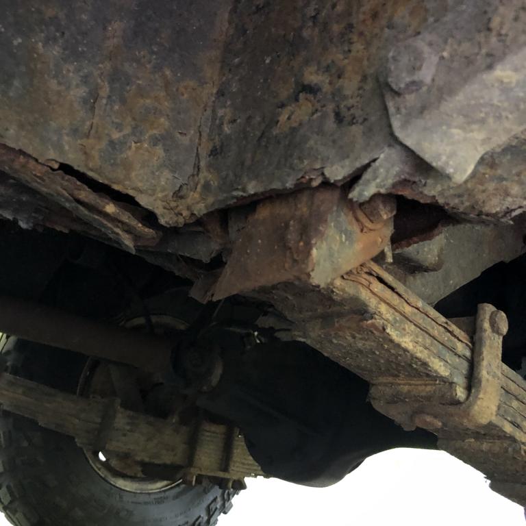

My '73 Station Wagon has developed some overt cancer in the left rear spring perch, and I am preparing for the worst as I take a screwdriver to the frame to explore the extent of it. The perch pushed right up into the frame rail.

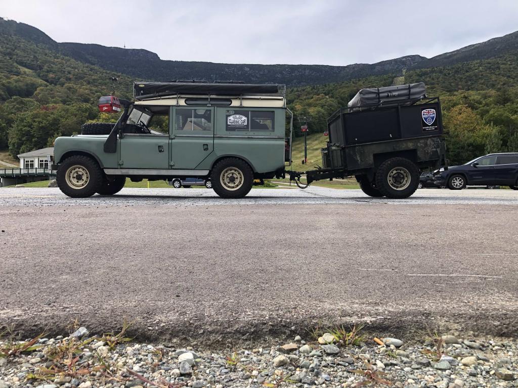

Exploring the following: weld in a fix, swap to a galvie leaf chassis (RN), or swap to a coil chassis (Designa). I am running Disco axles, p38 power steering, a 4BD1T Isuzu diesel with a NV4500 tranny behind it. She is a year round daily driver, and I log 5-6k miles a year. Thanks in advance for your thoughts.
