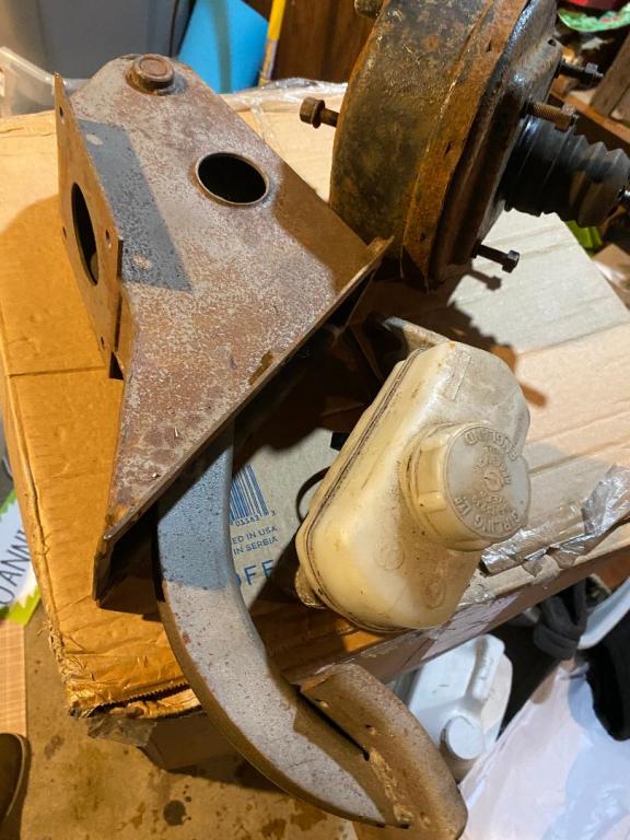

        I have a complete dual circuit set up that came with my project which i dont intend to use...im staying with the single line system with the old girling res. Have pedal box, servo, cylinder..not sure of condition of servo and cylinder but pedal box is in good shape and been blasted...if you can use em

          heres a picClick image for larger version

            didnt realize this was an old post but if someone can use it its free just pay the shipping..my project came with lots of extra parts i dont intend to use. thx
