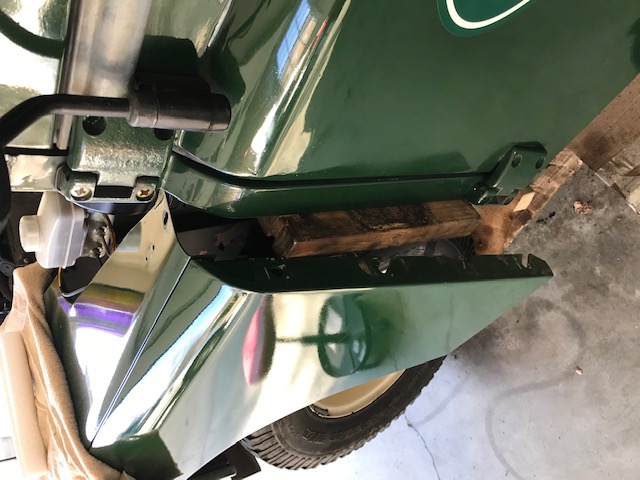

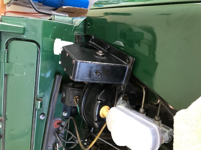

          It's been a month or so since I started this thread, but I finally got around to doing the repair. First I moved the fender as recommended. I found that it might be possible to remove the m/c from the pedal box but it would be a monumental pain to work in that tight area. Also I wouldn't be able to lube the pedal pivot or repair any pedal box rust if I didn't remove the pedal box and m/c as an assembly. I struggled to get the box out past the fender, but even with it pulled to the side the brake booster and m/c were in the way.

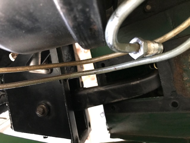

          As I struggled with the heavy pedal box I accidentally dropped it beneath the fender and the solution became clear - the pedal box assembly comes in and out from below, not from above! Working behind the LF tire I was able to drop the pedal box, turn it 90° to get the pedal out though the hole in the bulkhead. After replacing the m/c on my workbench and servicing the pedal box the whole assembly was reinserted from beneath the fender. Having the fender loose and propped away from the bulkhead gave move room for turning the pedal assembly under the fender, but beyond that was perhaps not needed. Photos posted below, sorry about the website turning them sideways.
Name:	Landy fender moved to side.jpg
          Fender moved to side
Name:	Landy - no way .jpg
          No way to get the pedal box out or in from above
Name:	Landy - going in from below.jpg
          Pedal box going in from below, pedal already though bulkhead hole
Name:	Landy - almost back in place.jpg
          Pedal box almost back in place and ready to bolt down.
