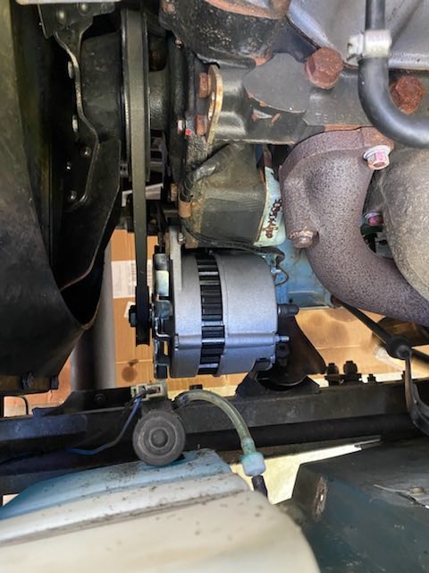

    I have a 1972 Series III. The front headlights lights are dimming and the horn is not working. Neither has been a problem in the past. I put a volt meter on the battery (engine off) after charging it overnight - read 12.4 volts. Turned on the engine and throttled her up a bit. Put volt meter on the battery while running and it read 12.2 (should be 13 to 14 with motor running). Alternator is only 3,000 miles old (see picture). Belt looks great and taut. Spinning like a top with the engine on and not making any funny noises.
    What is the best way to "test" the efficacy of the alternator? Advice requested. Other suggestions welcome too. Thanks in advance.
    I will note that the horn and headlights seem to be on the same circuit. I would deduce that is the problem if it were not for the fact that the battery is reading 12.2 volts with the engine running

    Sounds like the alternator has died or there is a wiring issue. I'd remove the plug at the back of the alt. and be sure all looks well there. Also be sure the engine is properly grounded to the chassis.

      Good advice Erik, as well as engine check that battery is properly grounded, a simple pull of the alt. take to Auto zone they can check it with a diagnostic tool,,, 2P,,,

        Finally tracked down the problem. Alternator was fine when tested. It was the dashboard charge light. I removed the bulb from behind dashboard. Ran continuity test on bulb - ok. Checked to make sure socket had power - ok. Put a touch of Vaseline on the bulb threads and screwed it back in. Appears the bulb had previously been perhaps 1/8th of a turn shy of a good connection with the socket....Started it up (charge light illuminated upon turning the key). Voltage at battery was 12.6 engine off, now 14.5 engine running. These trucks can drive you nuts. At least some quality alone time in the garage and a few cold beers. #Winning
