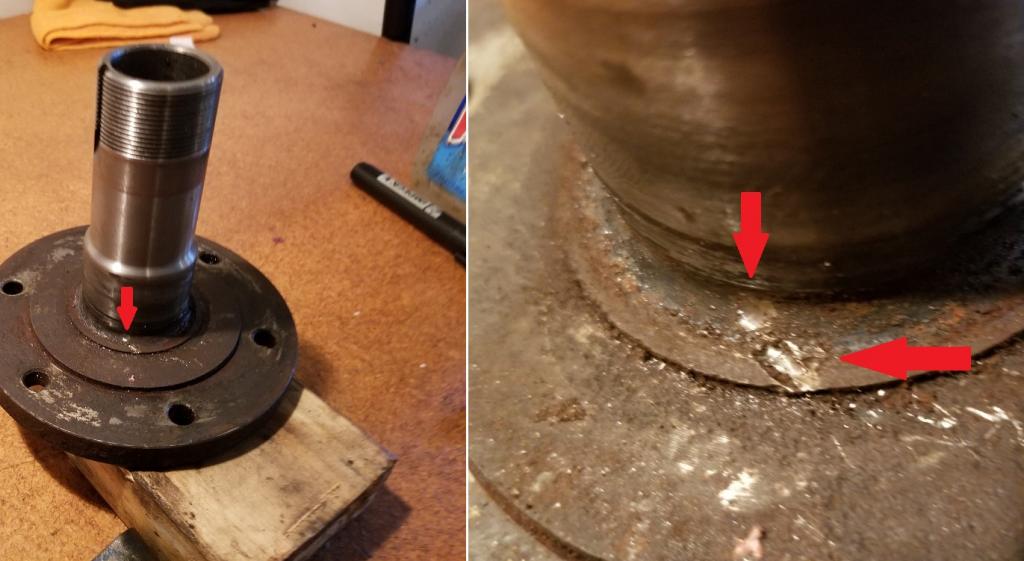

    1) When taking the hub seal race off of the stub axle (part #29 on the Hub Assembly diagram @ https://www.roversnorth.com/category...iii_drivetrain), I accidentally drilled through the race and took a small chip of the stub axle (aka the spindle assembly/part # 28). Rookie mistake, I know. Is this a big deal (aka needs replaced) or can it just be filed smooth? Pics included below

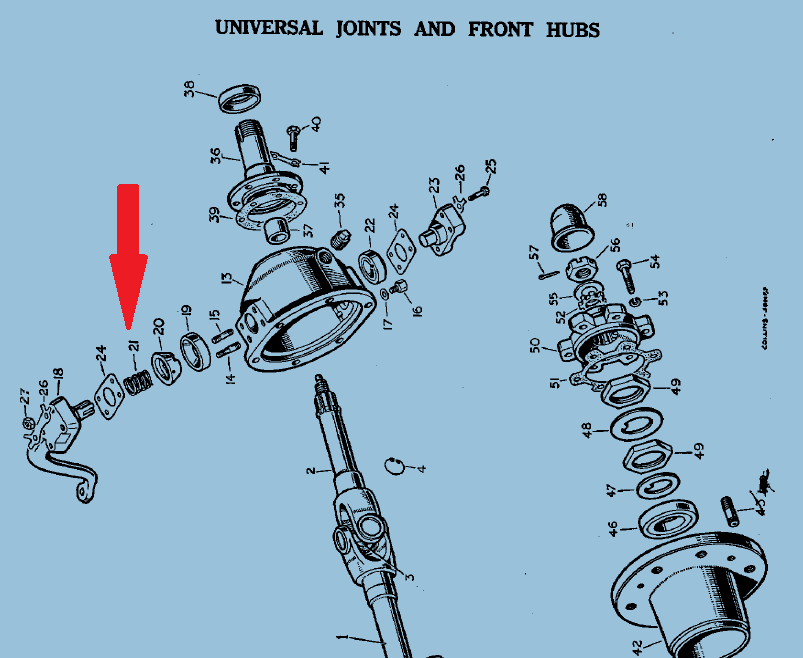

    2) In the Series III parts manual there is reference to a "Spring for cone bearing" directly underneath the shims for the steering arm, is this actually a part (pic of parts manual attached)? It is not listed on the Roversnorth diagram on the same page as above.
    3) In the hub assembly diagram mentioned above, what is part #27? In the LR Series 3 parts manual it is labeled as the "Bush for Driving Shaft", again is this a piece that needs replaced or is it already integrated into the half shaft?

    In my experience, you should be fine in regard to the nick. It should be smoothed down, but there's no sealing going on in that area. The oil sealing area on the stub is the inner circumference of the landing and the stub. The oil seal that seats into the hub assembly fits over the landing but should not contact the back of the stub.

      I agree with Roger. I wouldn't worry about the nick/drill spot on the stub axle. I've done this numerous times, using a chisel to remove the old distance piece, and never had one leak afterwards.

        You don't need that spring if you're working on a S2A. I think that was an earlier type.
        I believe the bushing (#27) was a brass piece that was on earlier Rover hubs, prior to the installation of a bearing (#6) in the swivel balls. You shouldn't need it.
          Phil
          I am interested in your S3 parts manual for the parts you refer , spring for cone bearing and the bush for driving shaft were both deleted during the Series 2 and 2A production run and according to two Land Rover parts Books I have including a S3 (RTC9007) , they never fitted to a S3
          The spring for cone bearing was part of the spring loaded cone swivel pin damping and was replaced by the Railko bush type in the mid to late 1960's . The drive shaft bush was deleted when a strengthened stub axle was introduced .
