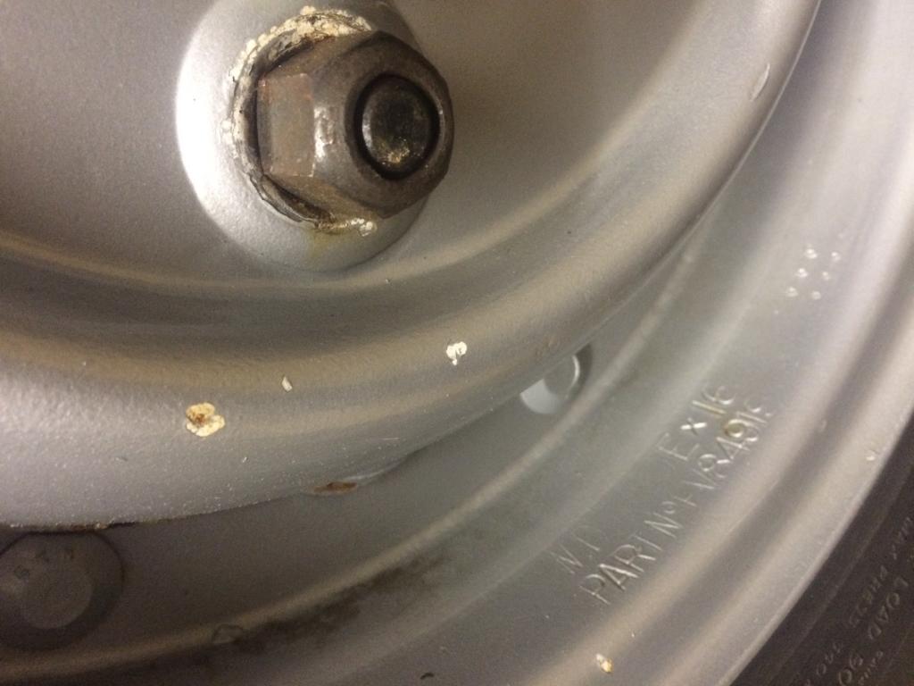

    Never knew what I had until I tried to find them on line.

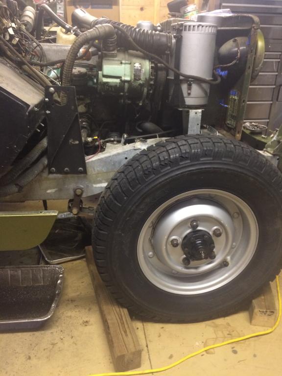

    Looks like my 66 Series IIA FFR has split rims. I thought they were new replacements that a prior owner had put on.
    Once I degreased them, they look fairly clean. Not sure if they've had a paint job, but they've been withstanding leaking wheel clyinders without a lot of damage to the paint.
    So - are these likely original to the vehicle?
    Does anyone sell them any more? A fast look through RN didn't show anything.
    Any experiences with them?
    Are they dependable, pain in the ass?
    Do shops charge more for dealing with them?
    If you look close you can see the tread separating on the tire - time for a replacement.

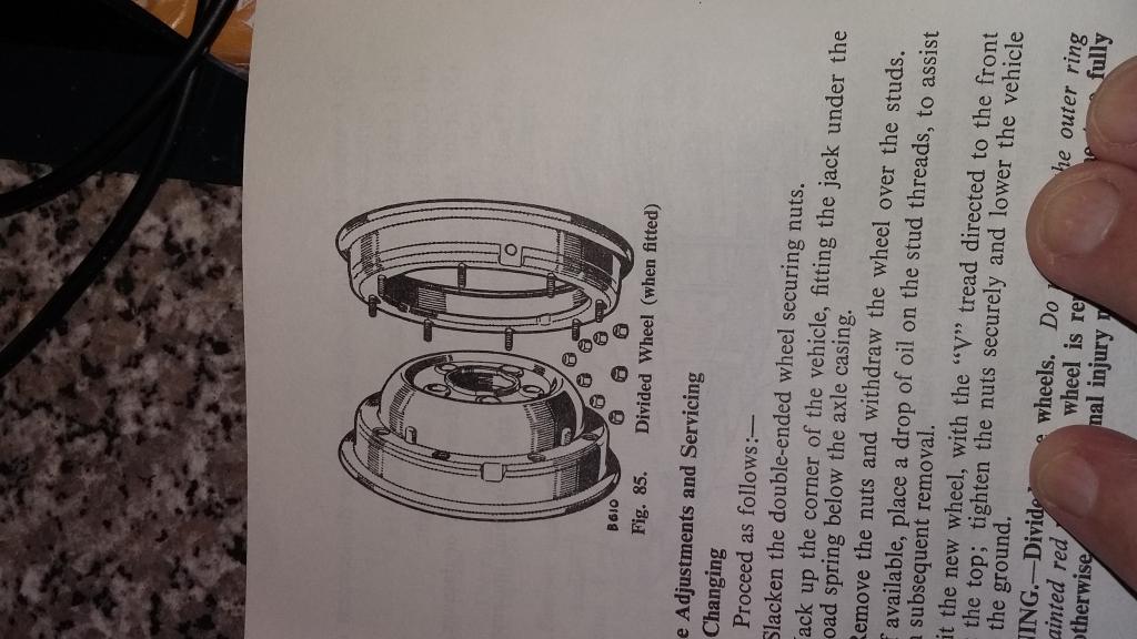

    I have a Army User Handbook dated 1964 which mentions divided rim wheels on 88" vehicle , but just refers to "when fitted" without stating exactly which contracts it applies . Tire Shops in UK where I am don't like them at all. Tubes ,flaps and too many bolts!Click image for larger version

            OK, I (Finally...) looked at the drawings for Land Rover divided rims (DUH!). They are NOT conventional Commercial split rims.

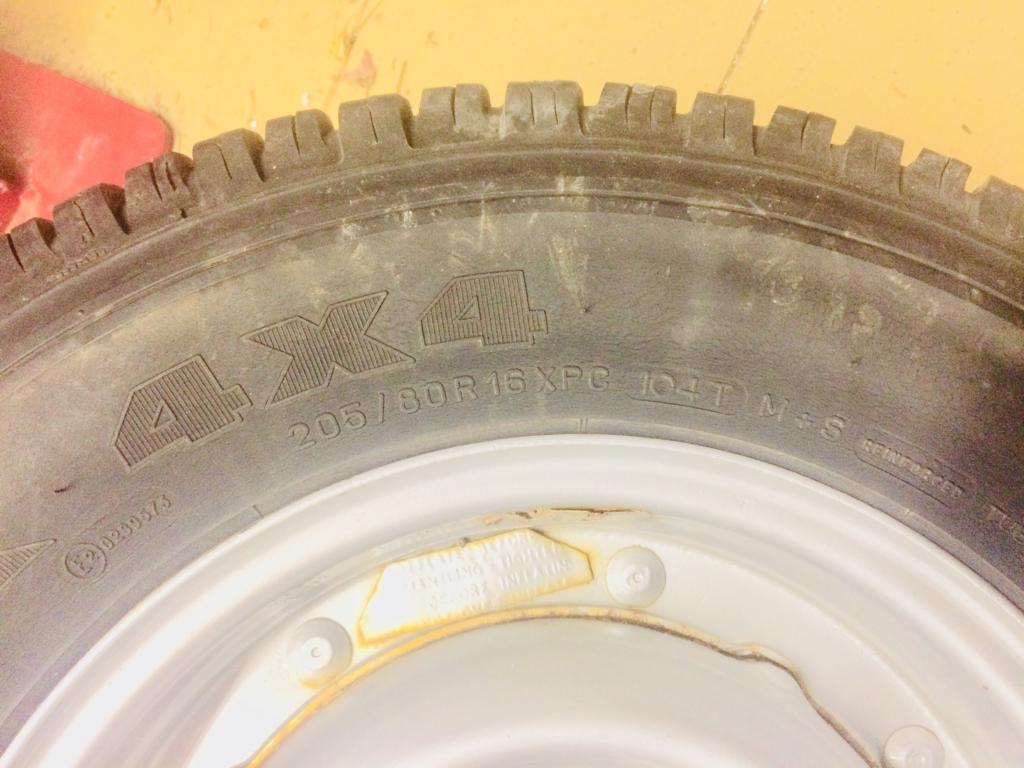

              Here's a very over exposed shot of a sidewall.
              The tire sidewalls indicate Michelin 4x4 XPC 205/80 R16 104T M+S reinforced tubeless
              I assume the DOT code means these were mfg in (gaaak) 1973
              i.e. a day older than dirt.

                | am certain the 4x4 XPC wasn't available as early as 1973 there must be another 4 digit DOT code somewhere on the sidewall
