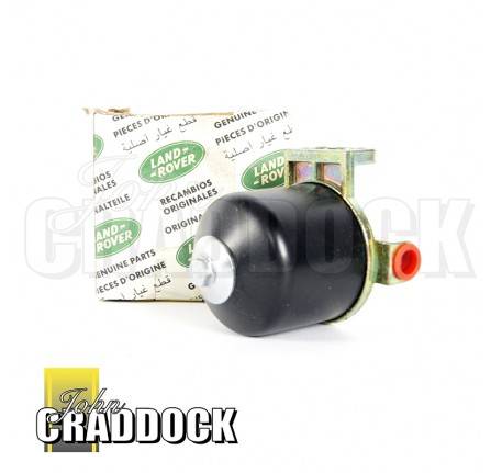

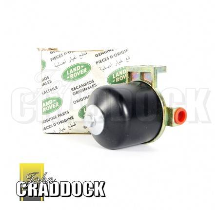

              My series 3 (about the last new one sold in the usa) has a filter, looks like a spin on oil filter but with a 1/4'' bolt holding it to the fixture (from the top) which is mounted to the fire wall up nearly touching the hood...... has anyone else seen that oem set up? i'm still using the original filter as I can not get a replacement for the AC D60 element.
              • roverp480
                3rd Gear
                • Jul 2020
                • 335
                #8
                Does it look like this one ?

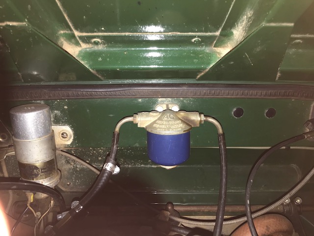

                  You must have what I have... Click image for larger version
Name:	Fuel Filter.jpg
                  I get the filter element from our host. I think this is it https://www.roversnorth.com/parts/js...r_element_fuel
