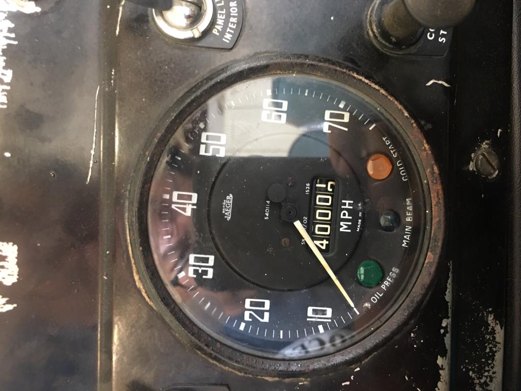

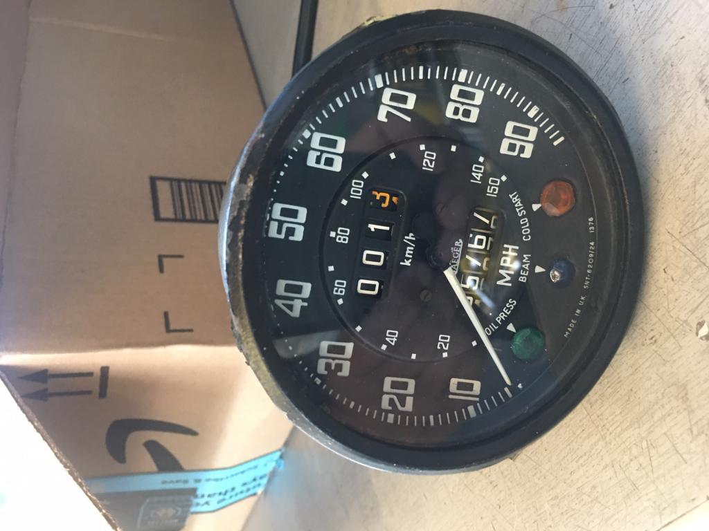

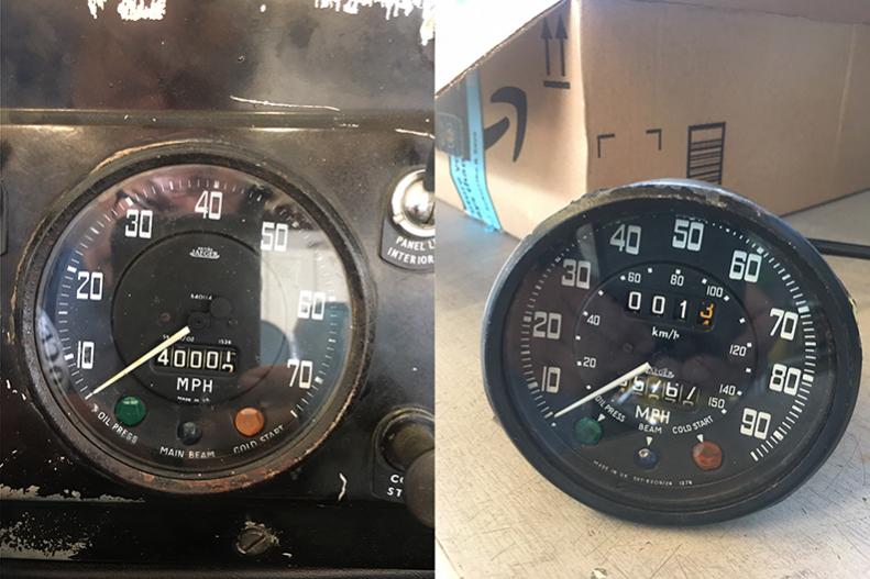

    I need to replace my 1968 88 IIa speedometer to get the odometer fixed. I have a 1376 series 3 speedometer that at want to use. I am running on 31x10.5x15 tires. I was reading about the different speedometers and from my understanding the 1376 is for larger diameter tires. The 1536 is pretty close to the actural speed. Can someone tell me the speed difference between the two.

      As the cable ( and engine) runs slower, for any given vehicle speed as the tire diameter increases , the bigger the tire diameter, the lower the number on the speedometer

        I did a quick check with a drill on the 1376 speedo. I is running 5mph faster than the 1536.

          . The two numbers indicate the two revs per mile and are circa 11% different , so that's what it should reflect in the drill. As a matter of interest what was the indicated speed and does the 5mph difference represent about 11% ?
