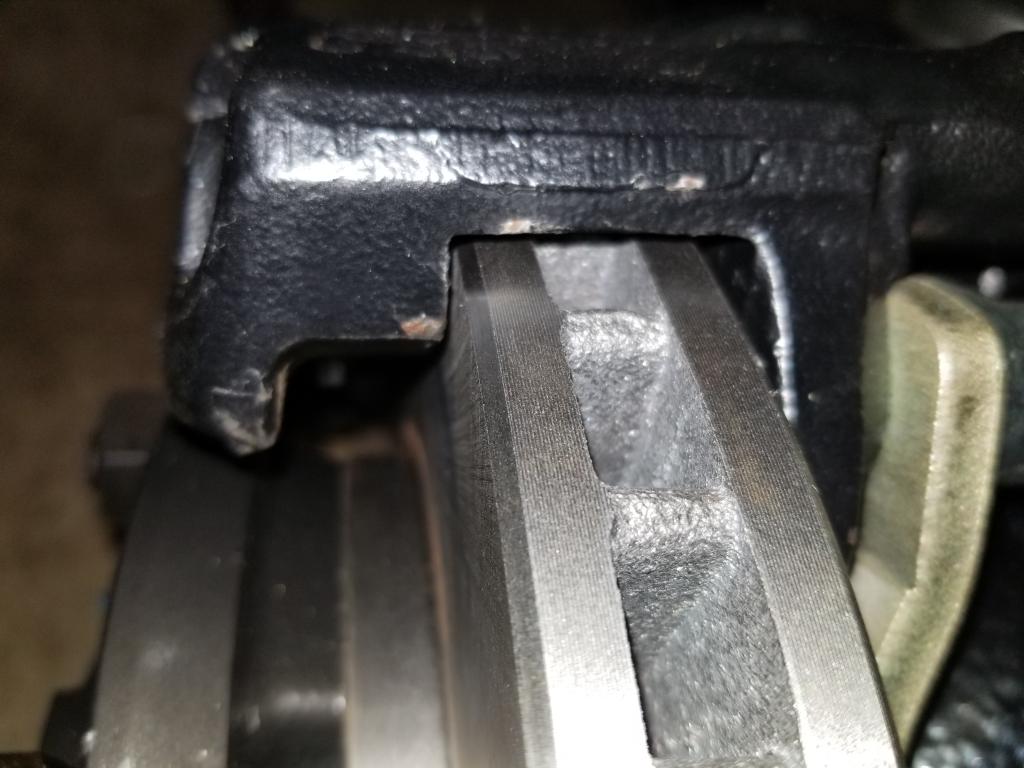

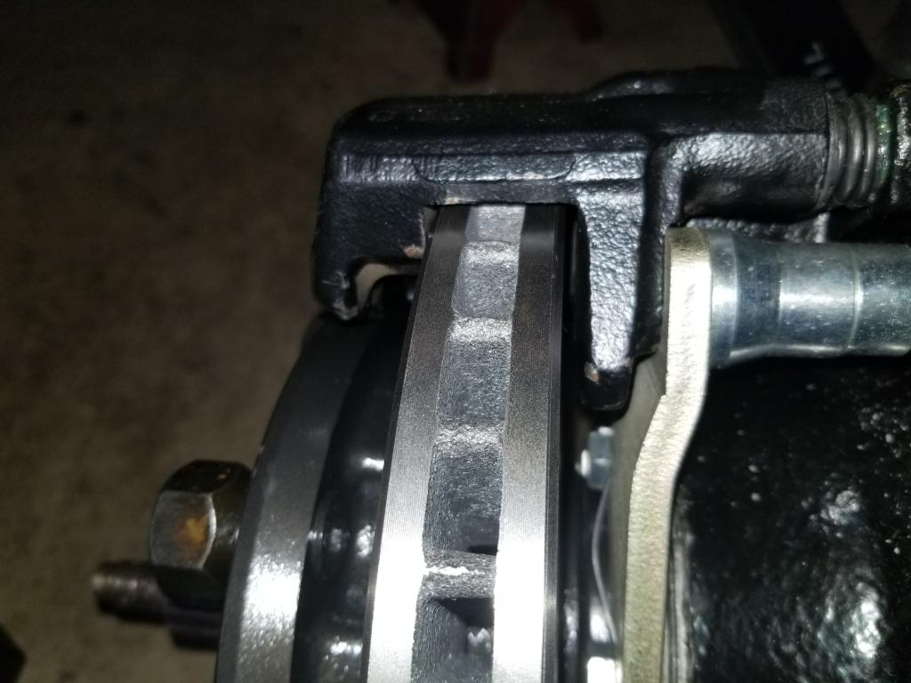

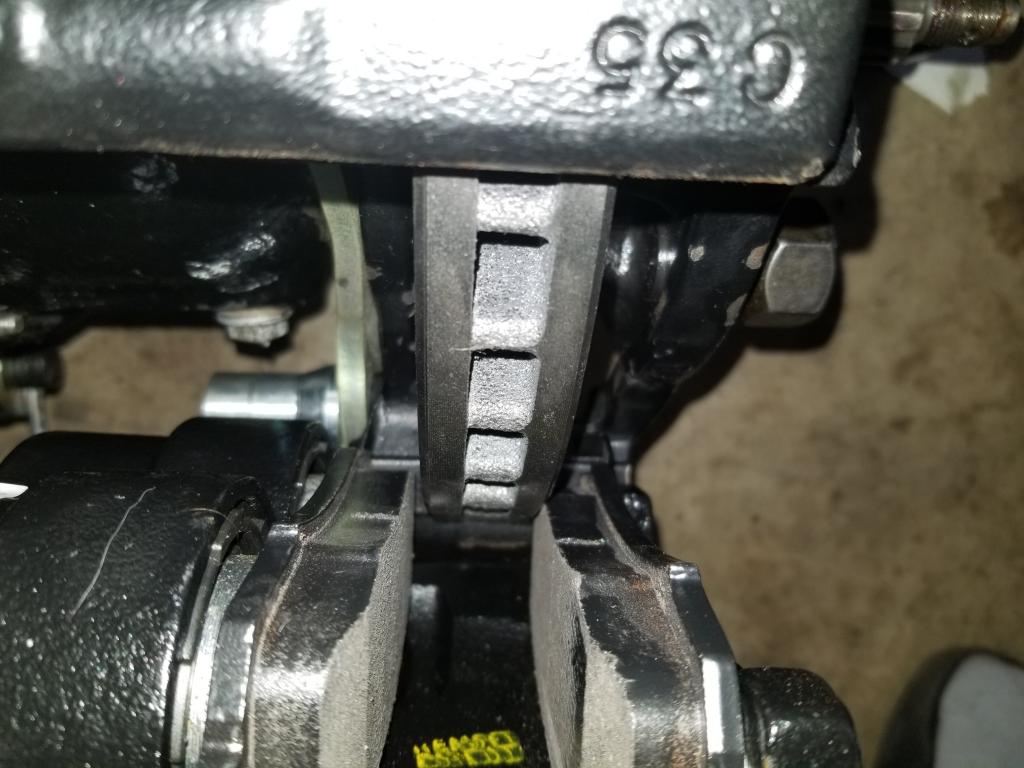

    Hello all,
    After a bit of research I decided to pull the trigger on the Torrel Disc Brake conversion kit for my 1970 Series IIa frame off restoration. I was very happy with the quality of the parts (although no longer shipped with calipers due to shipping costs, which isn't really an issue as most auto parts stores have the right ones) and the ease of install (instructions are great).
    However, after completing the install I found that the rotors are slightly offset towards the outside causing the outer rotor edge to slightly rub on the outer brake pad. It appears to be about 1-2mm offset from dead center of the caliper. I've tried torquing the crap out of the hub nut thinking that the hub or bearing races might not have been fully settled, but it didnt really change anything.
    Any thoughts or ideas? I've tried reaching out to Jeremy as well who is equally stumped. Appreciate any advice

              I actually tested 3 different brake calipers, all of which had an identical fit. Again the brake calipers are no longer mailed with the kit (due to weight), however, they recommend you purchase the following from NAPA: SE 4826A (Front right brake caliper with hardware) and SE 4827A (Front left brake caliper with hardware). I was initially told that these parts were NLA, however, they are available online through NAPA to ship to your house.
              Additionally, I tried reseating the inner bearing race/bearing and refitting the hub assemblies which improved things slightly. The rotor now appears to be more centered on the brake caliper, however, the outer brake pad still rubs in one small area. I guess I'm not too worried about this, as I have read elsewhere that this will wear itself in and self-correct over the course of a few miles.
