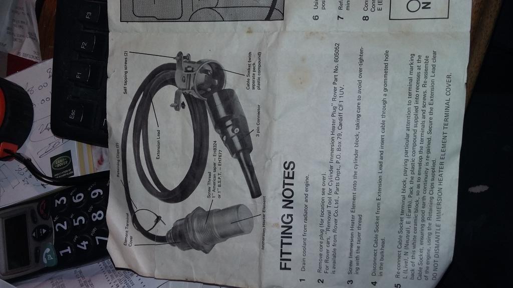

                As a bit of history, Rover used to supply a 110V block heater for Series 2A models 2.25 petrol & Diesel , part number 511303 , made by Bray Heaters in UK. No longer exist I believe . If you have a screwed aluminum plug with two internal ears just above the starter motor , that's where it fitted. Its a 1 inch BSPT thread .
