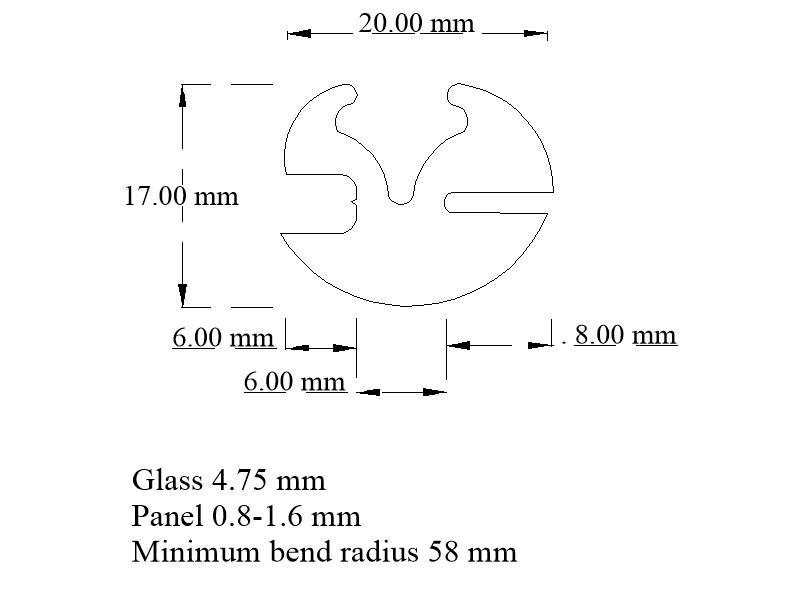

    Do you mean seals for the curved glazing like this ? https://coh-baines.co.uk/product/irs...-type-profile/Click image for larger version

      Originally posted by roverp480
      Do you mean seals for the curved glazing like this ? https://coh-baines.co.uk/product/irs...-type-profile/[ATTACH=CONFIG]13498[/ATTACH]
      Honestly, I'm not sure if this is what I'm looking for or not? I'm a vintage motorcycle guy, so I'm not used to dealing with glass. I'm working through a bit of a language barrier with my paint and restoration guy. He told me I should order all new seals, as it would be much cheaper for me to source them than him. (I can import certain things duty free.) I had seen seals for corner windows on eBay, and kind of figured I'd find similar kits for all the other glass. Should I be ordering what you posted for all windows or just corners?

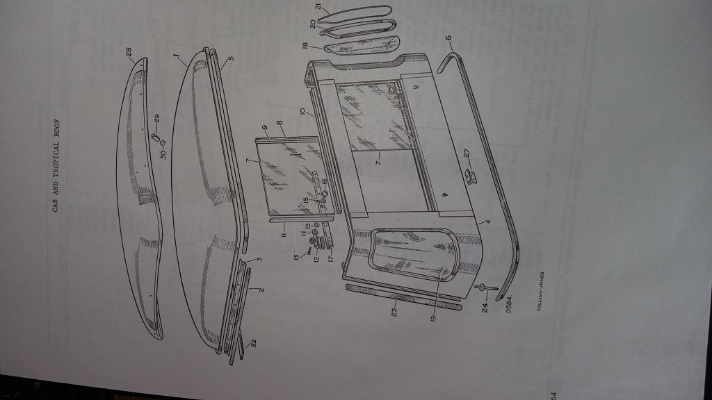

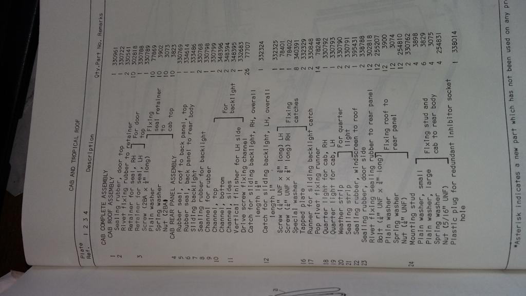

          When you restoration guy said " new seals" did he also mean the runners (channel) for the sliding glass in the door and rear glass in the hardtop . The runner channel can be purchased online by the foot and cut to length. The windscreen glass is, as reported, sealed by glazing putty and a thin rubber strip behind the ali. retaining strips inside ( Careful when refitting as its easy to crack laminated glass when tightening the screws ) . The same sort of putty is used to seal the fixed door glass . The rear sliding glass in the truck cab is all in runners . The curved pieces of glass in the corners is held by a two piece moulded rubber section, one similar to that I posted, while another fits in the Vee shaped groove to hold all together. You may consider getting a LR parts book which usually shows an exploded view
          of the assembly.

            [ATTACH=CONFIG]13507[/ATTACH][ATTACH=CONFIG]13506[/ATTACH]
            That makes a bit more sense. Thanks for the explanation and the parts snapshot. I'm not sure if my guy was talking about runners or not. I speak Texican at best, and he speaks Chilean Spanish. We play a lot of charades when it comes to talking fine details. I'm just going to get all the parts moving now that I know what I'm looking for and have him replace it all.
