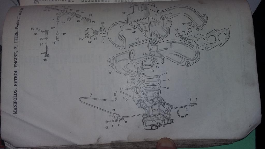

        The tube nut for the pipe into the carb is Rover number 260707 . https://www.johncraddockltd.co.uk/26...e-1948-67.html. It is a very course thread and possibly metric. The metal pipe and tube olives I have got from model steam engine suppliers . Has your distributer got a threaded connection for the Vac. pipe or a smooth tube which is for a rubber push on. If threaded, the tube nut is 3783 from the same place
        The Land Rover Series 2 club Forum is a good source of info. https://www.series2club.co.uk/new_forum/index.php. If you join the club they have all the shop manuals online to view.
        If you google the part number with Rover there might be a nearer supplier. Pictures from Parts book, why the illustration has inverted I don't know

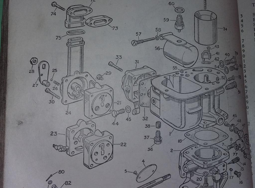

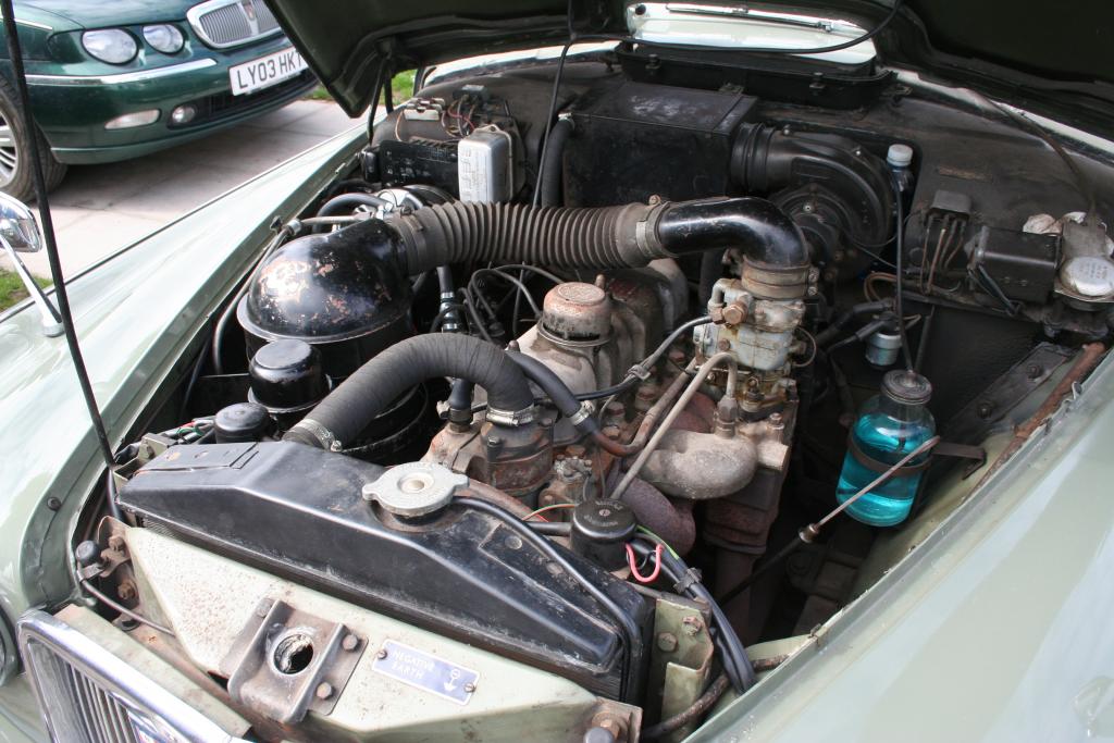

                    Item 23 in extract from Parts list. I believe heater is wired in parallel with the choke warning light switch , so operates when choke pulled out . I have only seen one on Rover Car I had once, fitted with the same LR engine, Rover P4 model 80 . If you blow up the picture, you can see a wire clipped the the fuel line to the carb. that leads to the terminal just above the spring loaded rod for the accelerator pump.
