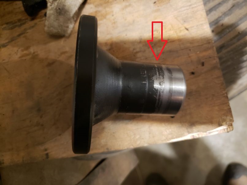

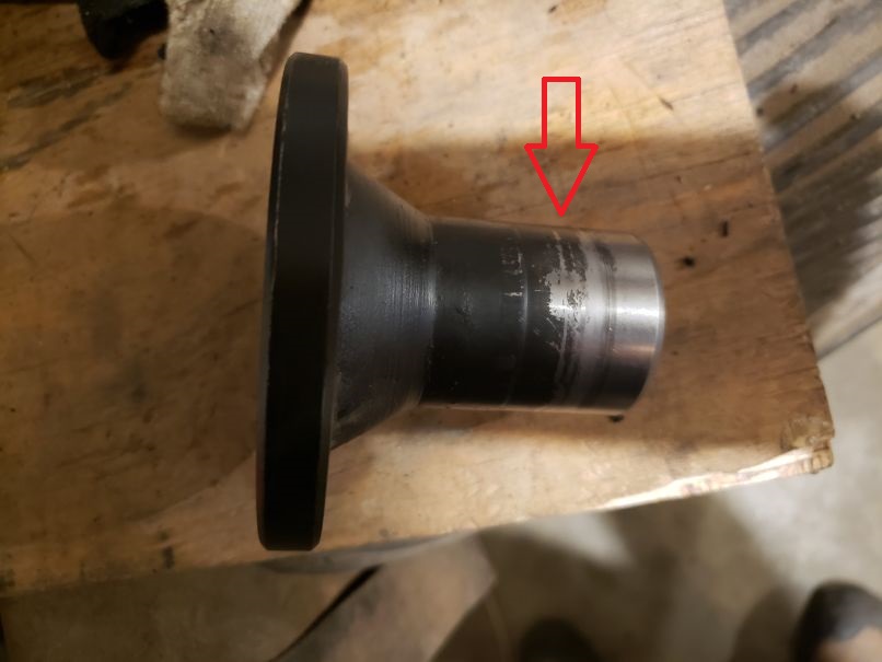

        Hi
        Additional information. I inspected the flange at the output of the gearbox (front shaft going to the front differential). I would like to know if it is normal there is a recess of around 0.5mm at the location. it look like wear. Is the part is supposed to be perfectly uniform diameter. If it is to small it can possibly explained small leak.
        What do you think?

          #5
          It should be a uniform diameter with no wear mark. . You could try using a SKF Speedi Sleeve . I have not used them but other owners report good results https://www.vsm.skf.com/us/en/produc...edisleeve-kits

            #6
            Good thank you. It is what I was thinking. Thank you for the advice for the sleeve but I will repair the piece and put it on a lathe to get the right diameter

              #7
              If you have any of the old leather seals, they have a pretty wide lip and would probably cover that ........ you could also put a spacer on the seal to move it to a different spot but i wouldn't reduce the diameter of the shaft.
