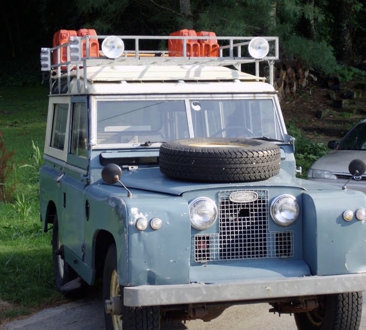

    A shot of Babe from her better days.
