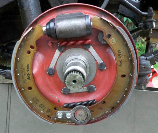

      First thing to check is that the shoe pull off springs are fitted correctly , The trailing shoes just have the one spring at the bottom connected to the leading shoes, . The leading shoe has the extra spring between the post on the backplate and the one on the shoe where the adjusted rubs. If the springs are fitted incorrectly it will give the symptom's you report . I fitted the top spring between the two shoes back in 1968 on my first Land Rover and had exactly the same problem as you. This is not a very good picture but you can see the top spring is connected to the post on the backplate and the Left hand leading shoe. The bottom spring is just connected between the two shoes.

          Just found a better picture
