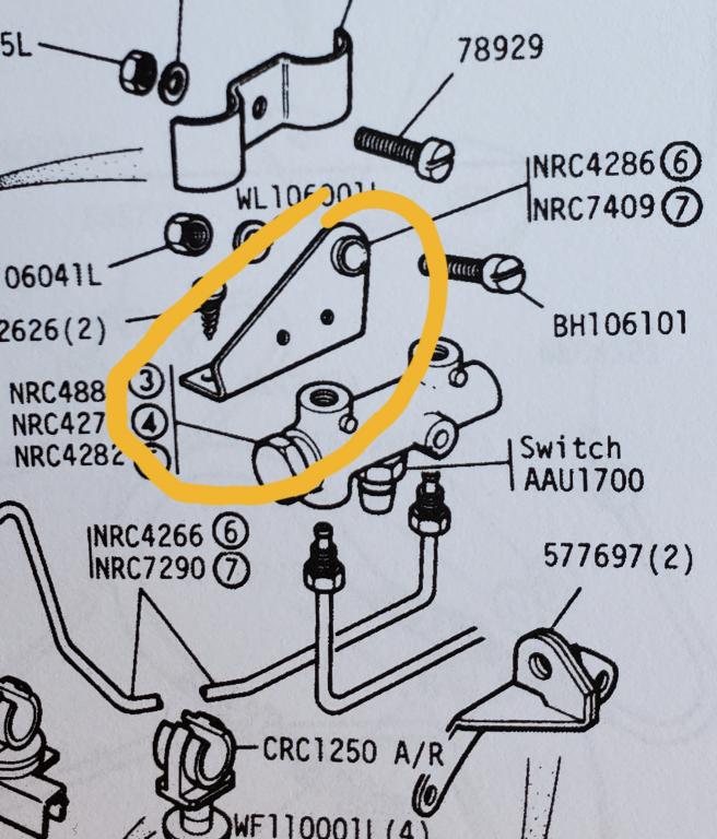

    I have a question for the group. I am in the middle of upgrading my 1973 Series 3 109(LWB) from single line brakes to Vacuum Power Assisted dual line brakes. Mostly for safety and increased pedal pressure, but also with a mind towards a front Disc brake conversion later. I'm tracking all the parts down from part numbers in the Parts Catalog (awesome resource, btw)., which is fun. But I can't seem to find the bracket that holds the PDWL shuttle valve. They don't make it anymore. Part numbers are either NRC4286, or NRC7409. I've attached a picture from the Parts Catalog, for reference. The car is a RHD, by the way.
    Does anyone have one of these they can sell or trade?
    Has anyone tried fabricating one? Seems a simple angled piece of steel plate with three holes. I think the fit is not critical either, since brake lines are custom fit anyway ( I will be installing new brake lines, and probably have to manually route them anyway, so some variation might be accounted by the lines routing). Still, I'd like to go with something close to factory. So, anyone have measurements? Can anyone measure theirs and do a back-of-the-napkin drawing for me? Hell, if you can bend a piece of cardboard over yours and trace it out with a sharpie, you'd be my new best friend!

    Here is a pic from the Parts Catalog (sorry, I couldn't attach an image from the mobile forum site).

      Make one, using the appropriate thickness metal and a vise to accommodate the bend, drill holes.

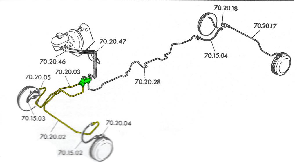

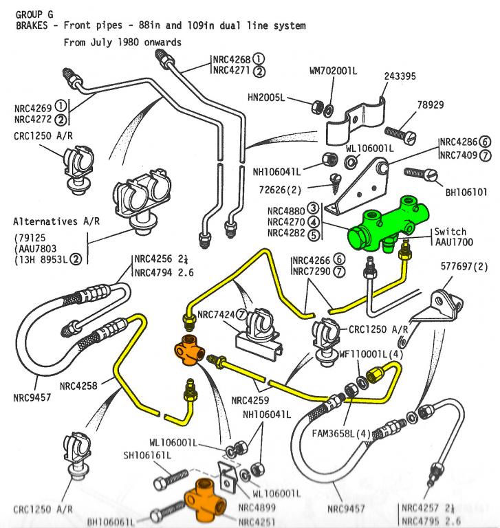

        Another (related) question for the forum:
        The shuttle valve/PDWL thing I got has 5 holes (two in top, two in bottom and one going out the front). I've seen there are 4 hole versions(omitting the front hole).
        I asked the very helpful guy at Pangolin4x4(forgot his name, sorry) about it, and he said it was for the front two lines. He said he kind of remember it being that way.
        I confirmed somewhat in the Green Bible manual. The official parts manual shows something different. I think I figured it out, but now I am torn by which better?
        Basically, when you use the "4 hole" PDLA valve, it's just two lines in-out. So, you have a "T" piece that splits the front line to go to both front brakes. This is how the single circuit works and is how the dual circuit is shown in the Series 3 parts manual.
        When you use the "5 hole" PDWL valve, the extra hole out the front is a duplicate of the bottom front hole, so you have two lines coming out for front brakes (right and left). This gets rid of the "T" piece and makes for dedicated brake lines going to each front brake.
        Okay, I get it now. I already bought brake lines and T piece for the original. But the amateur plumber in me thinks maybe "the less fittings, the less places to leak"? So, which is better?
        1) "5 hole" PDWL valve, separate dedicated front brake lines. Less junctions for less leaks potential.
        2) "4 hole" PDWL valve, One front pipe split by "T" into two lines at front. More junctions, but shorter runs of pipe, and maybe more "original".
        I can attach images if I'm not makings sense. I highlighted the parts in the same colors...
        First one is from the "Green Bible" (Land Rover Official Repair Operations Manual). Shows the "5 hole" PDWL and two lines coming out the front.

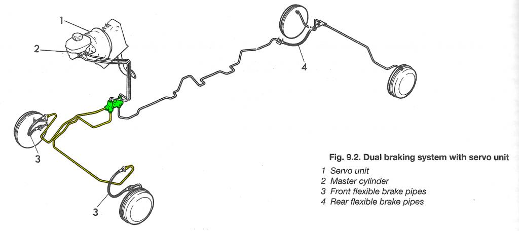

        The second on is from Haynes (Owners Workshop Manual). It seems to agree with the Green Bible.
        The third is from the Land Rover Official Parts Catalog. It has the "4 hole" PDWL and the single line coming out and split with a "T" piece (in orange).
