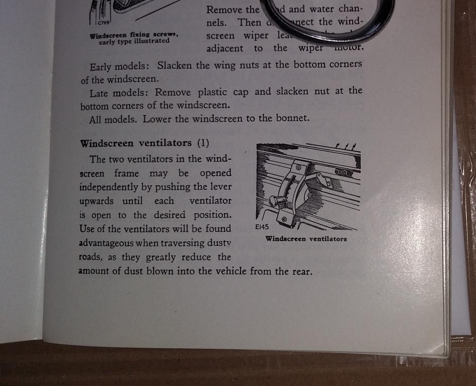

          I seem to remember that when Land Rover ran out of spare vent levers for the 2A, they offered the S3 version instead but it has to be put on upside down as the S3 worked in the opposite direction. It looked very odd indeed as the S3 has a 'J' shaped handle and upside down the hook bit is pointing upwards , it looks totally out of place . Whether there was any other modification to make it fit I am not sure. Picture from 1965 Owners Manual

            #6
            yea, i opened a vent on my 2a which isn't being driven (much) and was surprised to find it worked "backward".

              #7
              Yep, it appears the only difference in the part numbers is how it opens. So I ordered a set from a Series 3 and will live life with them upside down for now.
