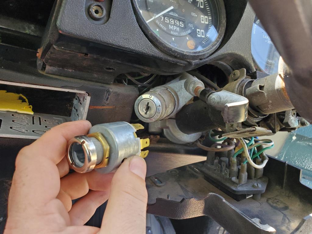

    I bought an ignition switch for my 1973 Series 3 (Pertrol). Our hosts have a similar model as the one I got, but mine is from Lucas. Looked all around the usual suppliers, and they all show this model fits Series II, IIa and III. Lucas is the supplier for LR, so pretty much "genuine". I was hoping we could rule out bad parts. This is definitely the one everyone's telling me goes into this car.
    So, I open up the column and dash today and this is what I see:

    Am I missing something? These look completely different. The Lucas one on the left - and every picture online - look like they should fit in the dash, just through the sheet metal, like in the II'S. But, I have a column ignition.
    Before you Series II guys say anything, YES, the Series III came with column ignitions! Looking at James Taylor's book "Land Rover Series III Specifications guide" on page 74-77 is basically what I got. Bone stock.
    But all the parts suppliers keep trying to sell me Series 2 ignitions. They "fit" in the same way that ANYTHING fits, if you're willing to drill out a hole in your dashboard and rewire. Not my idea of a direct parts replacement.
    Looking at the later Defender and other column ignition switches and they start to look more like what I have. Again, what's going on here? This is not a hybrid car...the dealership photos from 1973 look exactly like what I have (I didn't monkey around with anything). I'm starting to think Series 3 is closer to a Defender than Series 1 or 2. Like, I'm being led to wrong parts. It's crazy making. This part is not a direct replacement.

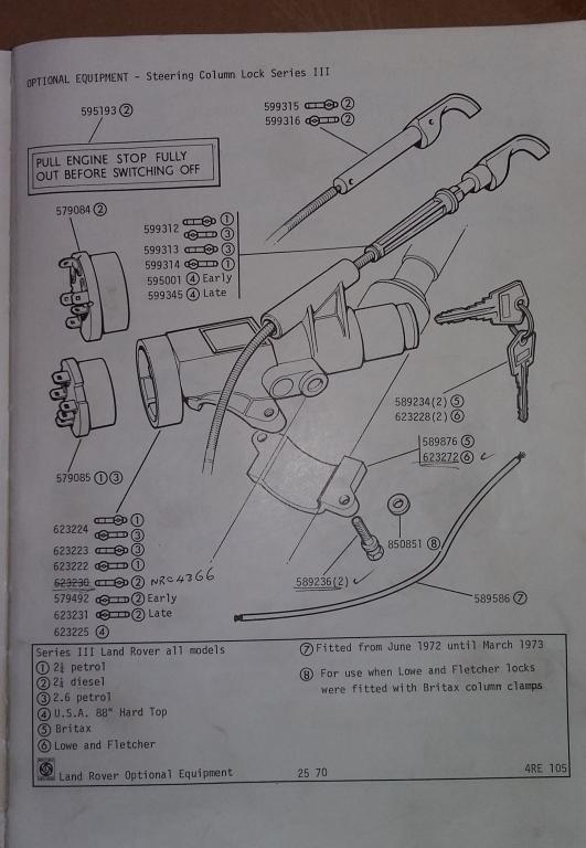

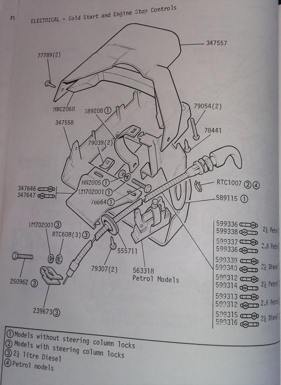

      I can only comment on the position in the UK. I had one of the very first S3 Petrol 's ( October 1971) and it did not have a Steering column Lock/ switch but the small individual Lucas switch as per the S2A mounted on a bracket clamped to the steering column which also held the choke cable, so that they were in exactly the same place as the lock, using the same cowls. A year later I had another S3, and that came with the lock. To just confuse matters the Steering lock is listed in the Optional Equipment Catalogue not the main one . The new switch you have obtained is the one listed in the main S3 parts book. Having two books does create confusion at parts stockists and indeed owners, if they are not familiar with Land Rover parts listing. According to my 1975 Optional catalogue the part number for the switch you need to go with the lock is 579085 . and is available under that number . https://www.roversnorth.com/search.a...&submit=Search
      I have added a couple of pics. from the relevant parts books, one showing the steering lock and its switch, plus the other showing the bracket used without the steering lock 589115

      You will probably need to take off the lock from the column to access the switch to change it. Has the switch failed? If its the steering lock that needs changing , I believe a new one will come with a new switch attached. For information the wiring is the same for both versions, with or without the lock.
