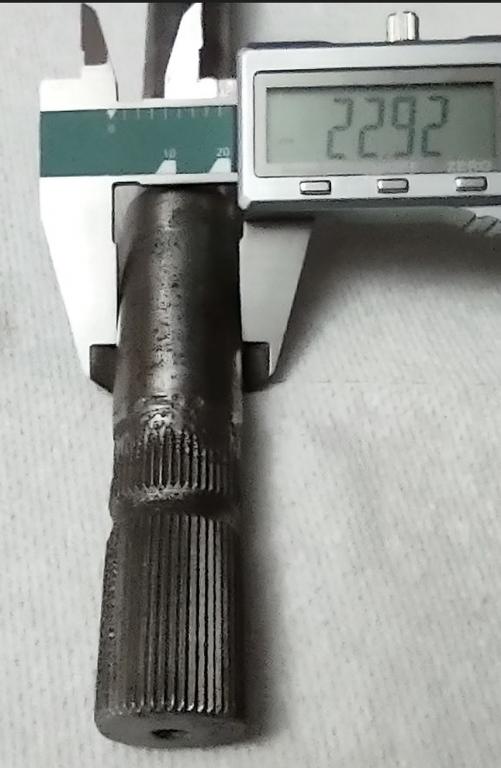

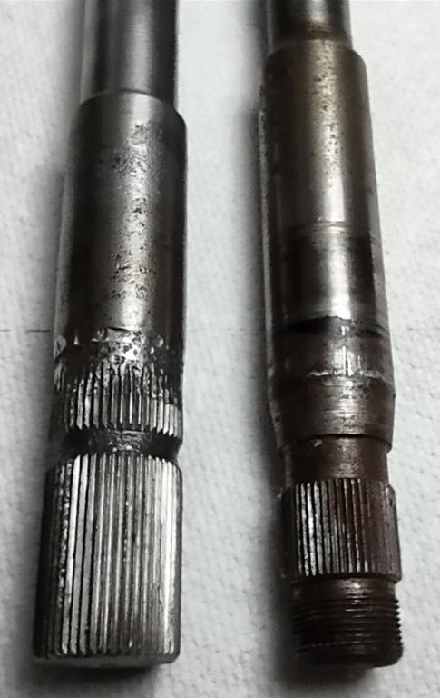

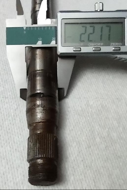

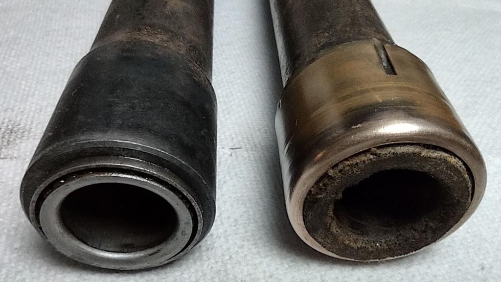

          series II, series IIA, series III steering boxes are interchangeable, but not LHD to RHD. The only difference between the years are the columns. It's quite easy to covert, there are corroded or worn out banjo boxes with columns which you can get cheap. You just take the column and shaft off the series II box and fit it with new ball bearings etc. It takes about an hour. Then you can sell your old IIA column and shaft for 100 bucks. Here are some photos below showing that you have to change the outer column as well as the shaft .
