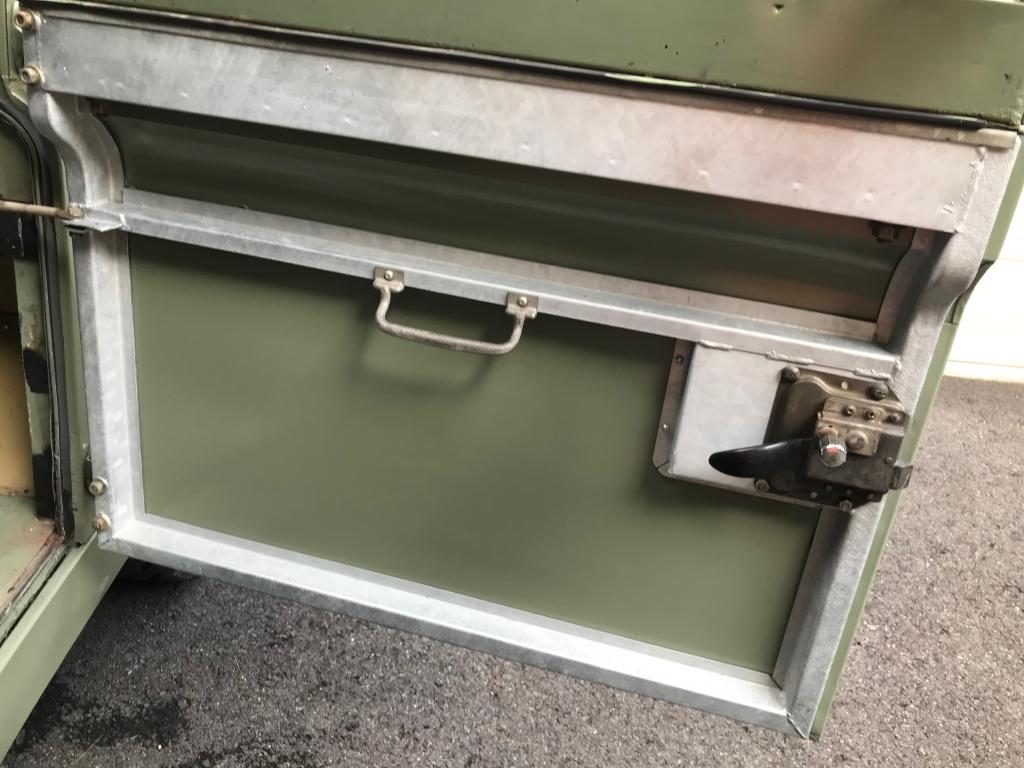

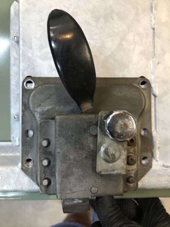

    I’m new to the community and Land Rovers, recently acquired a 1969 Series lla with substantial body character. I’ve picked up new replacement doors however the latch mounting holes do not line up the original latches, is this a common problem with replacement parts and will need to be modified to fit correctly? Thanks for any input.Click image for larger version

      I just looked at your picture again.
      I bet you could cut off that flap on the 2/2a latch that overhangs the outside of the door frame. The flap with the rivet on it. That would move the whole assembly "forward" and let you find the fit. Looks like the holes may align if you do that. Worst case, you use some shims to push the striker forward more to make up that space and keep the geometry of the lock right.. They sell shims for that.
      If you're worried about cutting that flap, don't worry it's not integral. The "anti burst" door latches don't even have that flap, and affix with the same bolt pattern(meaning the flap was never needed in the first place).

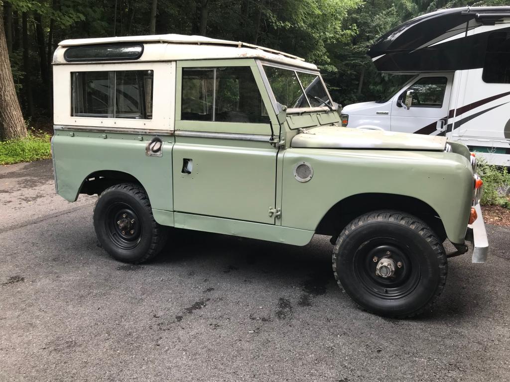

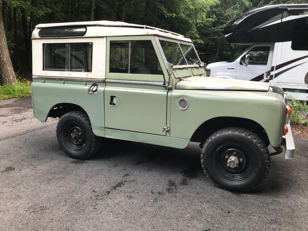

          vlad_d, thank you for your thoughts on this project it was rather involved but with quite a bit of fiddling I have new doors which is a major improvement from where I started. Yeah, I was surprised too at the variability of parts, I honestly expected a straight forward installation. I was close to returning the doors however I did like the fact that they have galvanized frames and decided to tackle altering the latches. Even though it was involved I have the satisfaction of tweaking things in to fit/work. With the doors being the culprits, your thoughts on latch flap were correct. I ended up just re-bending the flap vs. removing it on both doors. Once they were reshaped the holes lined up perfectly. The bigger issue was that the exterior door handles were binding on the outer skin. It took some creative clamping and muscle to bend the door handles about 1/4" in order to create the needed clearance. In the end I am happy with the outcome and Penny has new doors that close easily. Click image for larger version
