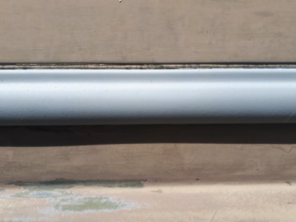

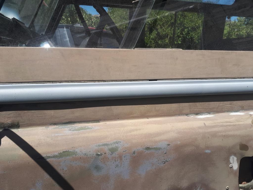

        Bought this paint thinking it might be the answer. However it looks just like any other grey primer. Dont think I will use it on the side trim but the rear corners are so bad I may as well use it there.

          Yeah...true galvanizing is not a paint, but a zinc metal alloy that goes on by electrolysis. So, any paint that claims to be the same...especially in a rattle can, is going to be suspect. Now, it may have rust inhibitors, and be a good base coat for some other finish. But it’s never going to give that same finish as galvanizing something.
          But...you know...not all these Series have to look like they just came from the factory. It’s your truck, right? So you don’t really have to have the galvanized trim. Mine is painted over. Probably a crime to true rivet-counting collectors, who cares? It’s protected from rust, and protecting these cars for more generations...so that’s fine in my book. No harm. A future owner can strip the paint if they care that much. No irreversible harm done. Besides, we have new technology now. How about powder coating? You can even get powder coating colors that look metallic, and might last longer than paint and galvanizing.
          Something to consider.

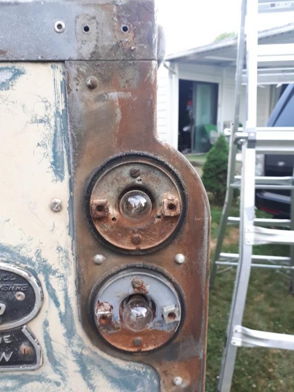

              Yes Im not doing a concours restoration. I just want it to look decent all one color not the four colors it is now. Drilling all those rivets to remove the trim is beyond this project. The side trim and windshield are really not to bad so I may strip that one I painted rather than paint the others. The rear corners have no galvanizing left. I took a wire wheel to remove the rust and if I dont paint them they would rust again.
