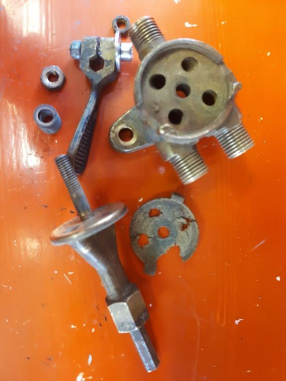

                Finally solved my fuel issue. The valve for switching tanks was leaking so sucking air when on the right side tank and no delivery. Bought some cork and made a new gasket and all is well.

                    'Im not fond of the changeover system offered by Rover, That cork gasket will easily dry out, crack, and malfunction, worse it could leak, and then you have fuel spilling onto a hot engine. I am investigating another change over switch. Tom's Bronco sent out a Ford changeover, much better valve, I will just need to get fancy about mounting, and attaching fuel lines. I would like to also fabricate a bracket that holds the valve so that I can devise a way so that it activates the Tank sensor switches like the old unit does.
