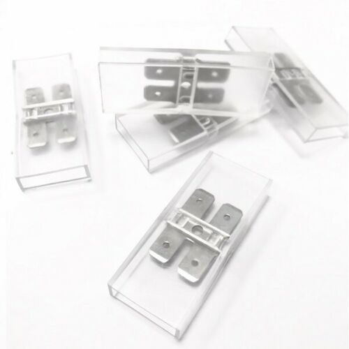

    I used this type of thing to make the A & A1 connections Click image for larger version

      Where did you buy these connectors?

        I live in the UK and got them from a local Auto Electrical shop and have occasionally found them online .
