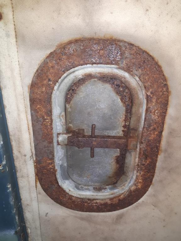

    All 4 of my vents are rusted and seized. After using penetrating oil for 3 days and a hammer and punch they still did not move.

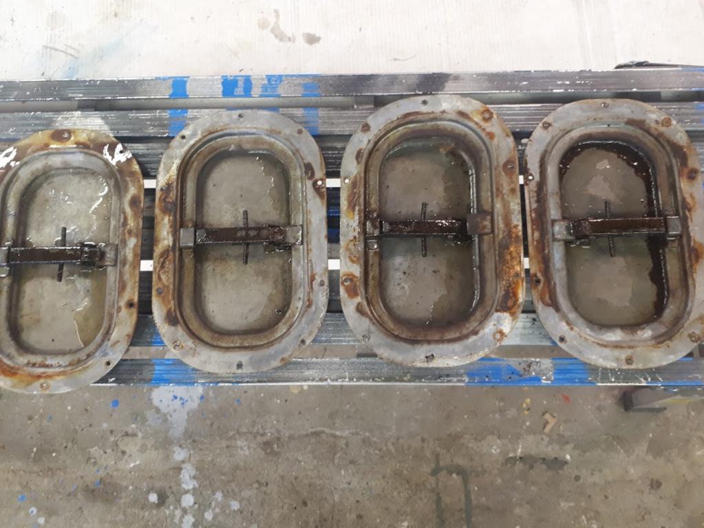

    So I removed all 4. Only 4 screws out of 10 were holding each in place. All came out except 2 on one vent so I cut the heads off with a dremel tool.

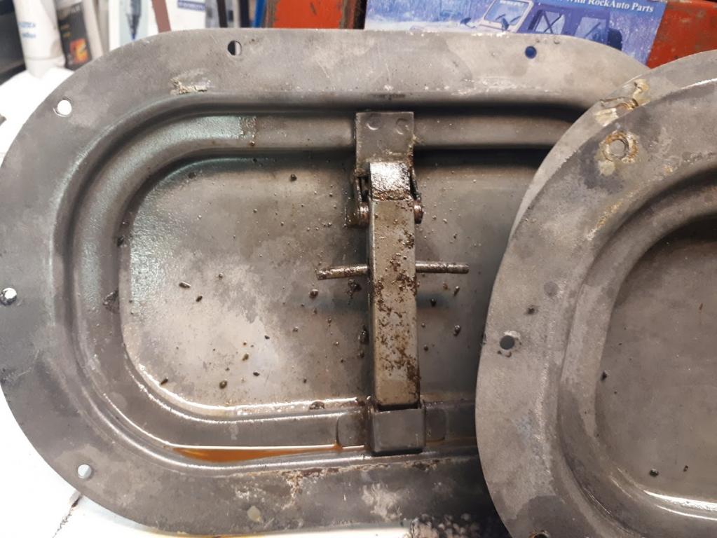

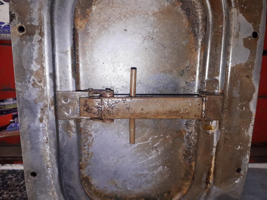

    After only a couple hours looking better.
ID:	174693 Click image for larger version
    Still seized however. So will soak some more and hope for the best. As a last resort I will remove the pins holding the latch parts together and replace with machine screws. The spring inside may need replacing anyhow. We shall see.

    No luck in loosening the seized parts. I had to remove 2 pins for each vent as I expected. The seized part.
    After more acid and cleaning.
    Surprising the coil spring inside was good for all 4. Reassembled with screws.

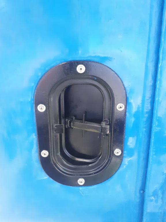

          Reinstalled
