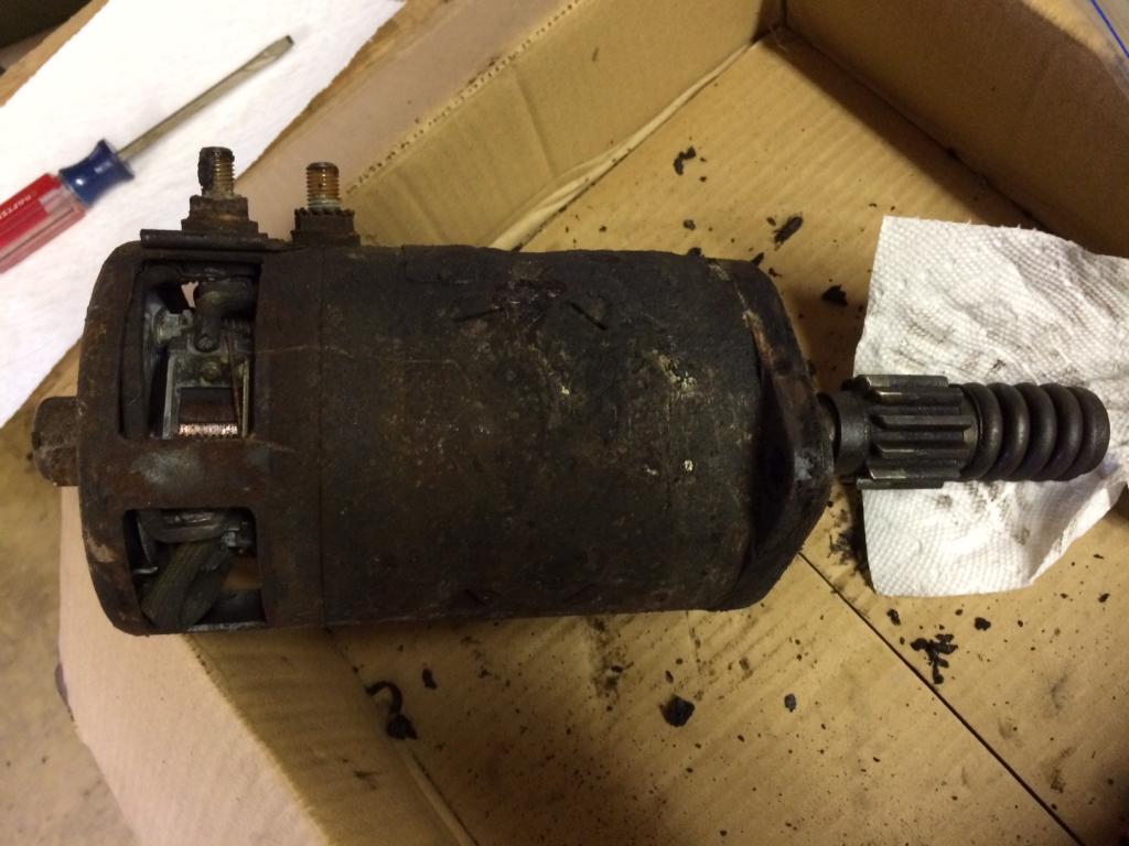

    Upon inspection, there was only one 7" bolt holding the starter ends together...yikes. Things area bit loose. I lift and tied up the brushes with cable ties, removed the one remain 7" bolt, and eased the rotor out of the casing. Commutator is a bit pitted, but not work. No electrical smell. No solder thrown everywhere. Front bushing seems a bit wobbly. I'll check continuity on the windings, but things looks intact.

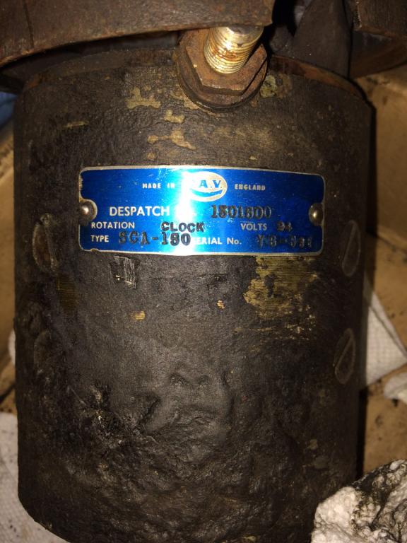

    After carefully removing a bit (well, a lot) of tar from starter, it reveals it's a CAV unit.

    I cannot remember where CAV originated but by the time yours was made it was part of the Lucas empire . Most Diesel & truck parts ( which are usually 24 Volt) were manufactured under the CAV brand. The Diesel parts (injector pump, injectors, filter etc ) on Series Land Rover were all CAV. Normally it was only Military Land Rovers that had 24 volt systems, and of course FFR LR's were 24 volt.

        The starter looked sketchy - missing a through bolt and the brush cover was rusted and floating around.
        I think the tar undercoat held it together. Internally it looked clean and unburned.

        Degreased the starter dog, applied dry graphite and things worked smoothly. Repaired the brush cover which was rusted through and missing it's end clip. Being loose on the starter it might have been shorting out against the positive terminal. After rebolting, bench tested it, voila it spun nicely.
