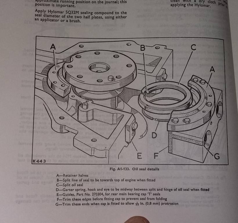

      In my experience, if the crank seal leaks it will tend to drip out of the threaded hole in the flywheel housing . These are two sources I have experienced if the leak is at the back of the oil pan / block interface. One is the Pan gasket, a new one could solve the problem. The other is around the side and bottom of the two T shaped cork ( or composite) seals down the side of the rear main bearing cap. They can dry out and leak . Its item F on the picture . I cured one by taking off the oil pan ( sump in the UK ) and could see the end of the seal had shrunk so there was nearly a 1/8" gap at the bottom off both sides of the bearing cap. I cut two pieces about 3/16" long off a new T seal and pushed them into the two holes where the seal had shrunk back, leaving about 1/16" protruding . 1/32" is recommended by Rover , the item G in the picture , but I double it . This gets pushed in when the pan is put back and all being well , compresses the cork making it seal again, as well as filling the holes at the bottom . One can do this without removing the engine or gearbox. Alternatively one can replace the T seals which needs the engine or gearbox out. I cured one by taking off the flywheel and housing . cleaning the area around the cap to block joint with brake cleaner and putting a bead of RTV Gasket sealer along the cap & block joint face and fitting the flywheel housing back before it cured, which did stop the leak without recourse to removing the bearing cap to replace the seals.
