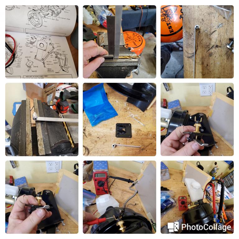

    Hello Rovers!
    I am in the middle of a single-line to dual-line plus Power booster upgrade on my 1973 series 3, 109" RHD truck. I'll do a comprehensive post when I'm done as I think people might find it interesting to see the costs and challenges. But here's a little one to give folks some initiative:
    I have been scouring the parts catalog and all the usual vendors(including our hosts) in this list:
    ...and no one seems to make part#592567! It's a little spring arm that levers up and pushes the brake switch on the power booster brake tower.(See my image from the Parts catalog). Such a tiny, insignificant part...but it stops the build!
    After your encouragement on my last discontinued part, I decided to fabricate one! If you have this same problem, here is a breakdown of the steps. Took about 30 minutes and let me continue the build.
    1) Source a piece of steel or aluminum stock, about 3/4 inch wide and thin enough to bend/shape on the vise, but not bend by hand. Use the hinge fitting on the plate (AEU 1468) as width.
    2) Also, get an aluminum spacer or small tubing to keep a nice round fulcrum for the new spring arm. Home Depot has both of these.
    3) Use vise to clamp about 1/4 inch of aluminum stock. Use a carpenter's square so you know you are clamping exactly 90 degrees, or you will roll the aluminum like a cresant roll and be unhappy.
    4) Use a hammer and roll it 90 degrees.
    5) Get a drill bit of approximately the same size/radius as your round stock spacer. Clamp it into the elbow of the bend you just made, in the vise. Use the square again to make sure your stock is 90 degrees in the vise jaws.
    6) Use hammer or vise to press the aluminum stock around the drill shank, forming a round over that the little tubing can fit in.
    7) Put the tubing/spacer in the newly formed round fulcrum. Congratulations, you've made a tiny leaf spring! Use the vise and hammer to tighten up the fit, being careful not to crush the tubing and make it come out-of-round.
    8) Cut the width of the tubing to match the inside of the hinge hangers on the plate. Put it in there and use a Cotter pin to secure it in.
    9) I had no idea of the length, so I cut it long. You can trim it later. The final length is about the same width as the mounting plate(see parts catalog diagram). You should also put a slight bend at the end to make it easier to install in the brake tower.
    10) Test fit. I had to remove the vacuum diaphragm to install it. There just wasn't enough space to get the plate on and even reach the front 2 mounting screws with the diaphragm on. This was easy for me with new parts on the bench, but would be annoying in the car. Watch those tiny screws! You drop them and they vanish from the universe...
    11) Adjusting and testing. After I assembled everything and screwed the new switch in, it didn't really have the range of motion I expected. I mean that the action of the brake pedal didn't lever that little are as much as I thought it would. That image with my fingers cycling it...yeah, it only goes through about 1/4 that range installed in the tower. So, that means it's about proper adjustment to get the switch in the right range.
    12) I hooked up a voltmeter and set it up to measure resistence(Omega setting). The next part is finicky, because you need 4 hands. But, some lead clips or female electrical connections help hold things while you move the brake pedal. This might be easier installed in the car, but I did it at the bench in case I had to disassemble everything again. Luckily, it was not that bad, and just involved spinning the switch in or out until the range of motion matched the open-close circuit of the switch. It was a bit tight. The actual range on the brake switch is about 1/2 turn. So, if it's in too far...the brake light would be on the whole time. If it's not in far enough, the light never comes on. That difference is a half a turn. So, I backed it off a 1/4 turn and got it in a decent t range. I'm still not happy with it...so I'll adjust it further on the car, with the lights powered and the brake lines full and pressurized. Right now, on the bench, I have to push the pedal down almost 1/2 way through for the light to switch on. That feels excessive...maybe might not come on in light tapping. But then again, it may feel different in actual use. I used to have to hammer on my old leaky brakes to even do anything, so it's probably reasonable on Series trucks that you're half way through the travel of your brake pedal before it starts grabbing. I can adjust when I get it in the car. Just mentioning it here as a "pre load" kind of step...just getting it "in the ballpark" before final assembly.
    So, that's it! It works. There are two other places for these brake switches, depending on your package options. Folks with single line systems will have an in-line pressure switch at one of the front junctions. Also, the non-booster brake tower has a switch at the front of the pedal, like modern cars. I was going to do that, if this didn't work. But trying to keep things stock and somewhat matching the parts catalog. So far, I'm happy with it. So if you have a similar need, you can try this.
    Oh, also need to mention that the booster brake tower is a repro one fabricated by Pangolin4x4 as its also a discontinued part (but available at their website).

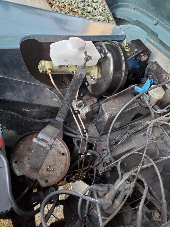

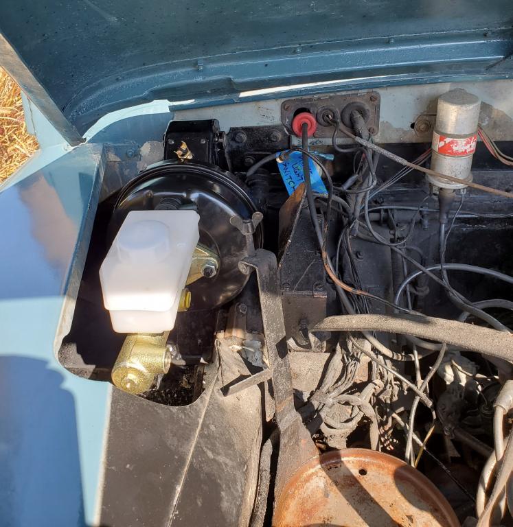

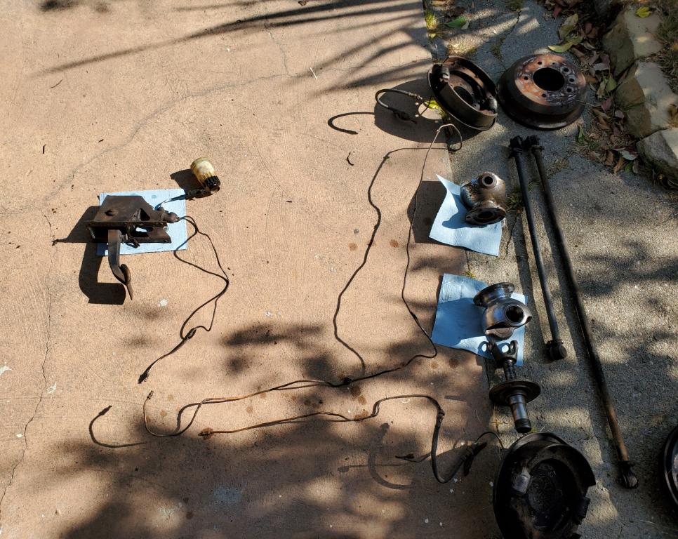

          Had a nice weekend of work. Here are some pictures of the old system and the new system.
          Old, single-line system. Also, the old drums and some suspension bits I replaced recently:
          The new dual-line system, with vacuum power booster and new brake tower. You can see the plumbing layout:

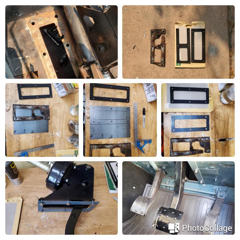

          Also, isn't it the unexpected things that take forever!? My firewall/bulkhead is so rusted. But I don't want to replace it just yet...so I had to fabricate a backer piece to sandwich the rusted mounting area...to stabilize and reinforce it:
          And, because folks talk about this...I can confirm the 8" Booster Diaphram and Series 3 Tower fit without cutting the fender(wing) and the standard hood(bonnet):

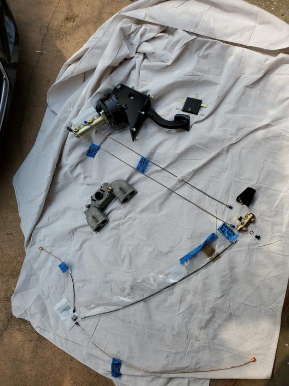

              Another 2 weekends spent under the Rover, working on brake lines this time. I'm rethinking my whole approach. I thought I'd share, in case someone is doing something similar.
              I was trying to avoid buying $200 of specialty flaring tools, and spending time measuring and cutting, prepping lines. I bought Land Rover part number pre-cut and flares lines instead. I picked the ones out of the official parts catalog...matching part numbers to get a "factory" engineering, I assumed. Well, I had mixed results:
              1) The front lines LH & RH to the "T" fitting went in okay. Since they are pre-cut and flared, they come a little long, so that you have a little wiggle room for custom fit. Well, they were about 6" too long. So, I had to put a needless "Z" in them to take up the slack.
              2) The one going from the "T" junction to the PDWL valve was about 1 foot too long! I ended up putting a gentle loop about 4" diameter to eat up the slack. This looks wonkey...and I had other problems that means I'll have to throw put this line...(more).
              3) There are about 4 setups shown in the Parts catalog for this dual-line setup. There are some with the PDWL valve flipped upside down...and some with it rotated back-to-front. I didn't think it mattered, but it DOES! The thing that matters is that PDWL/Shuttle valve has different threaded holes in it on all sides! So it matters what your brake lines are, and what the lines from your Brake MC are!
              I'm doing all new parts, so it should just work, right? Wrong. I'm all in the British, SAE standard, bubble flare...but it's still a mess.
              The "top" 2 ports of the shuttle valve are 7/16"-20. The "bottom" 2 ports are 3/8"-24. The 5th "front" hole is a 7/16"-20.
              My "rear" line nut(going to rear brakes) is 3/8"-24.
              My new "front" line nut is 7/16"-20.
              But, the crappy part...the "front" line nut is a short one. It won't seat fully. The threads stop, and the line is still loose. So after bending it all up and installing, it won't seat. I needed it to have a long thread. I think it was meant to go into a 3-way "T" instead, which is shorter?
              So, the LR part number shows interchange...but the reality is different.
              So here comes the wisdom:
              * Don't bother with pre-cut lines!!
              * They are almost impossible to get alignment and length right (unless pre bent for your exact car, too).
              * They are not guaranteed to have the right flare nuts size on them(often not listed online).
              So, I ordered 25 feet of new CuNiFer line from Fedhill, along with EXACTLY the flare nuts to spec, and a solid bench flaring tool, pipe cutter and deburring tool. In the end, custom lines are the only way to go to guarantee you get exactly what fits.
