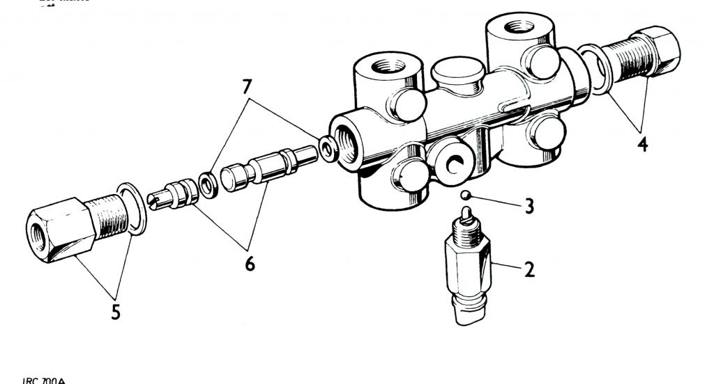

    See a diagram of the parts below.
    How it operates
    The Shuttle valve has 2 lines coming in the top, and 2 lines coming out the bottom. Each set of lines is an IN/OUT setup, with the valve able to block the circuit. Along the cross axis, the valve has an access port where you can service the Shuttle plug and Seals. Sometimes, there is also another hole on the other side of the cross axis. This is just a duplicate of the front lines circuit. You can plug this up with a bolt (NRC4137), or run individual lines to the front left & right brakes...Basically like a T. There is also a center hole which is fitted with the PDWL switch. This switch is also removable to give access to the Shuttle valve when pressurized (more on this later) or to replace the switch.

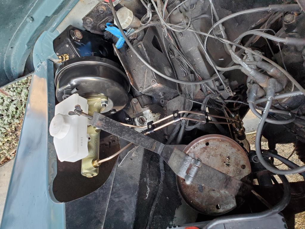

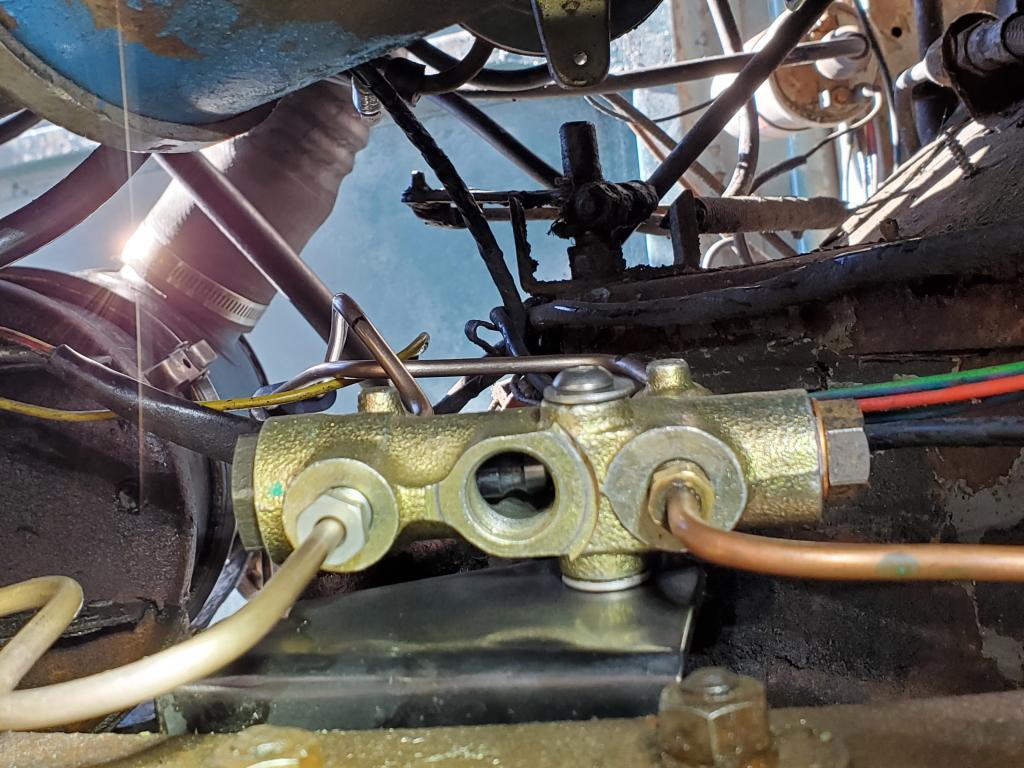

    If you have existing lines that don't reach right...or they were flipped coming out an old Shuttle valve...then you might be forced to plumb a front to back flip with the lines from the MC to the Shuttle valve. I had to do that (see pic). Again, just identify your MC type, and then visually follow the lines...ensuring the lines eventually going to the front brakes get the larger volume circuit.
    You can just see the flipped lines on top in my picture. The out lines below the Shuttle Valve(not visible) were straight forward, front going to front and back going to back. I had the >1980 Master Cylinder.

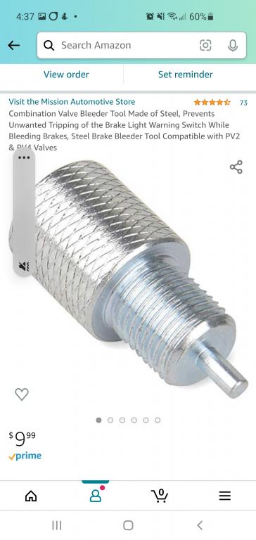

      1) American car mechanics use a little tool that replaces the PDWL switch with a one-piece plastic or metal bolt that just holds the valve centered. You can get it for about $8 and it just screws in, holding the valve from tripping. Then you bleed the system as usual...and replace the PDWL switch when done. The only problem is, I couldn't find any online sources for a British version. Unfortunately, the thread size is different for GM Combination Valves to British Rover PDWL valves. But, if any forum members can link to a British version of this tool, that's the easiest way.

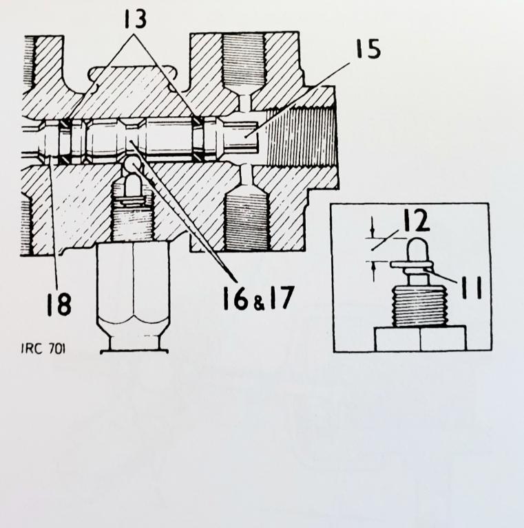

      Use a flathead screw driver to gently center the Shuttle plug. It floats in there, back and forth, and shouldn't take much to push it back to center. Center is where the saddle part sits in the center of the access hole.(see pic).
